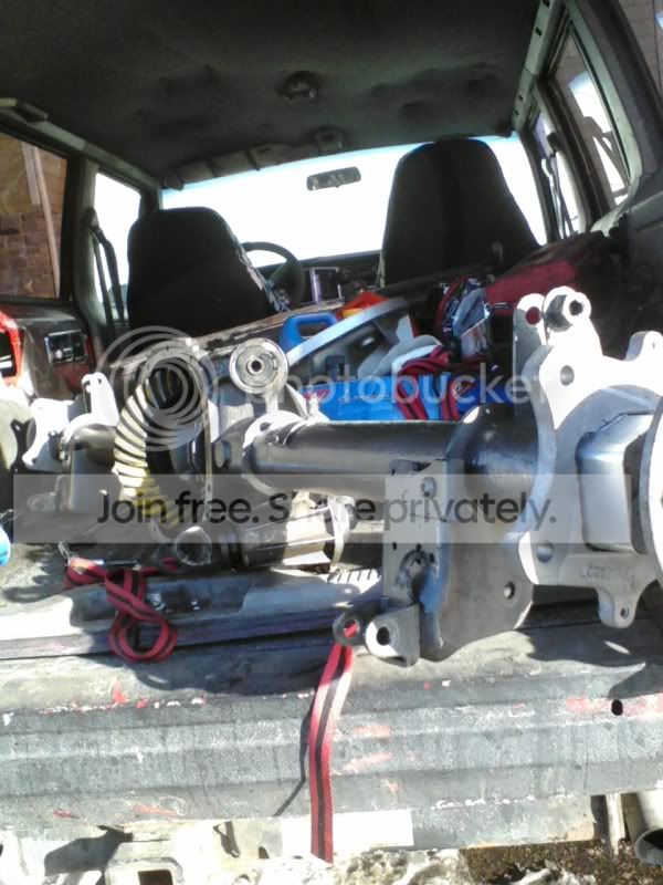

Update: I got moved up 3 weeks on my orders, so no Vortech install for now, it will go on the 351w after the build up. but I did get the axle done, painted and ready for oil!!! it looks sick with the Saleen girdle and grey hammerite paint
here are some pix, Im gonna take some more of the finished product tomorrow.

Got the rear axle in the car, swapped a fresh transmission in the car and took her for a drive yesterday. The gears are a nice improvement, and its much easier to drive. I dont know if the stud girdle was a good choice, I will know when I get the panhard bar installed someday. its sooo nice to drive my car!!
