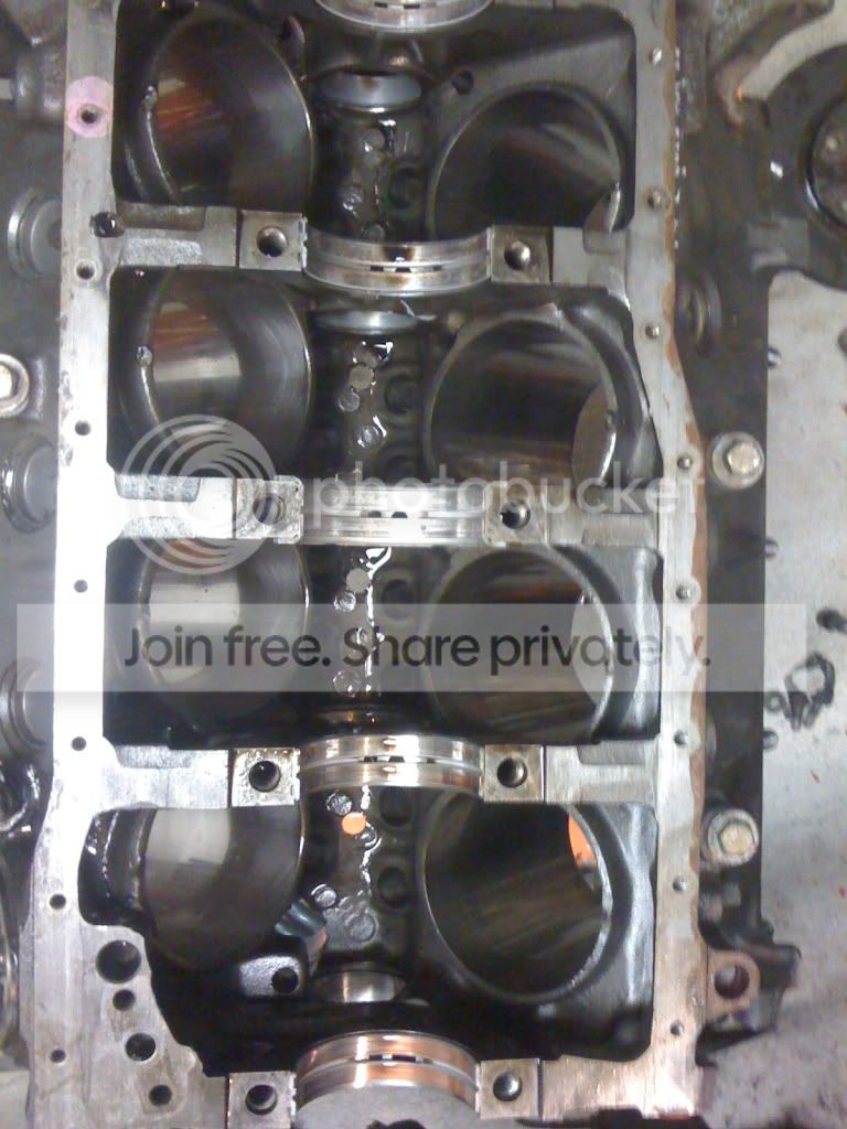

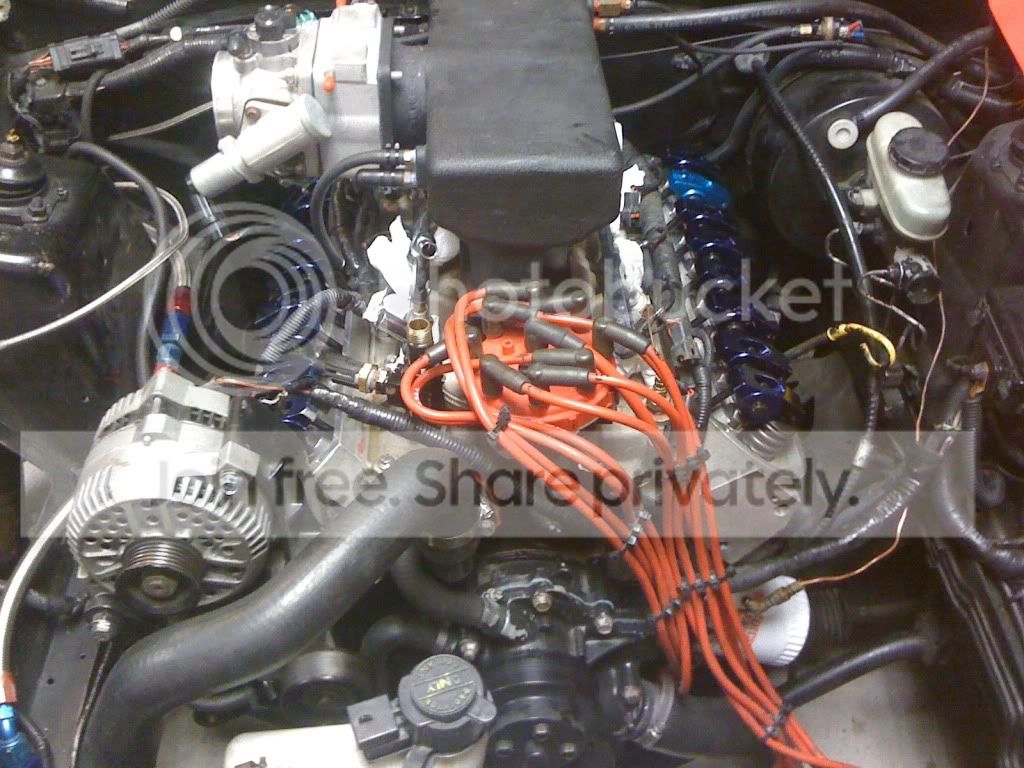

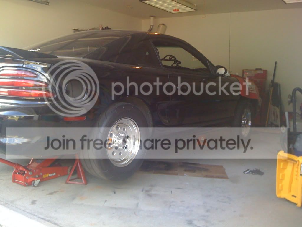

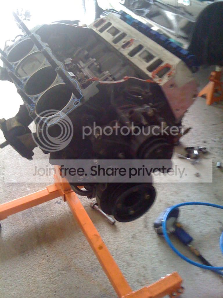

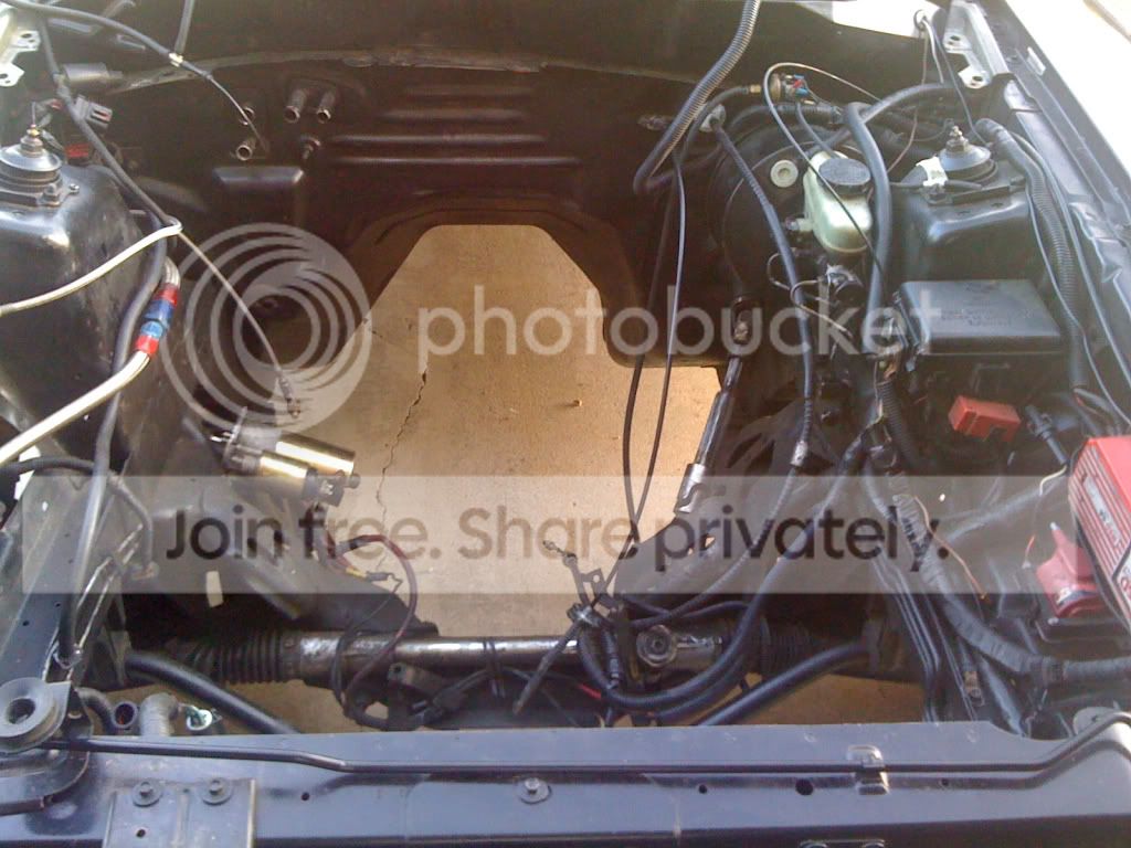

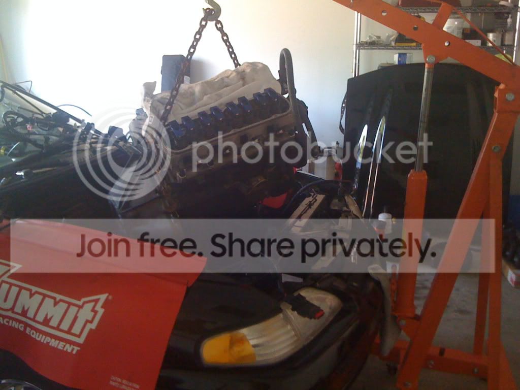

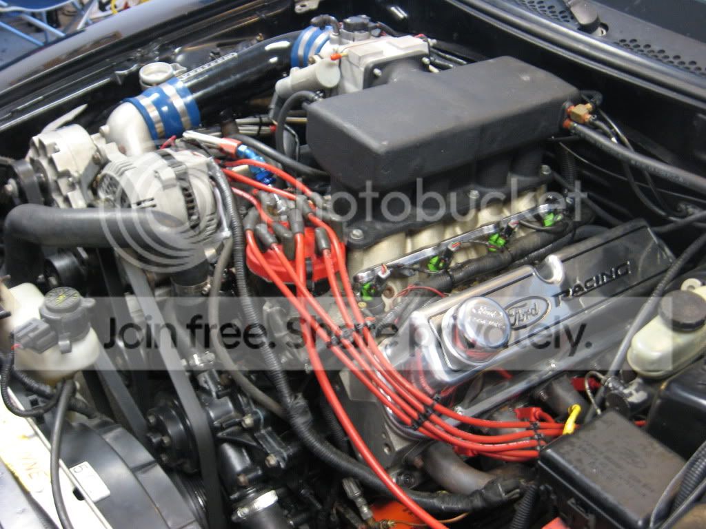

Well to start off my car is a 95 mustang gt. It had a 351w out of a 94 ford lightning in it with a vortech s-trim supercharger. I installed a methanol injection kit on it and at 11psi. the car made 560hp and 540ft.lbs. at the tires. I drove the car to a car show a couple of weeks ago and like any person with the same disease as me I decided I had to have more so I am going all out this time around here are some pics of progress so far.
Before
Supercharger gone
Out with the old!

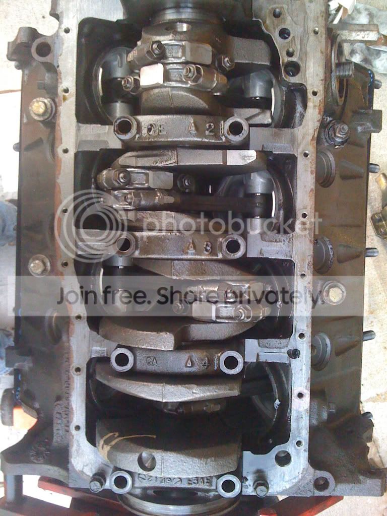

My disaster
BLOWN 95GT

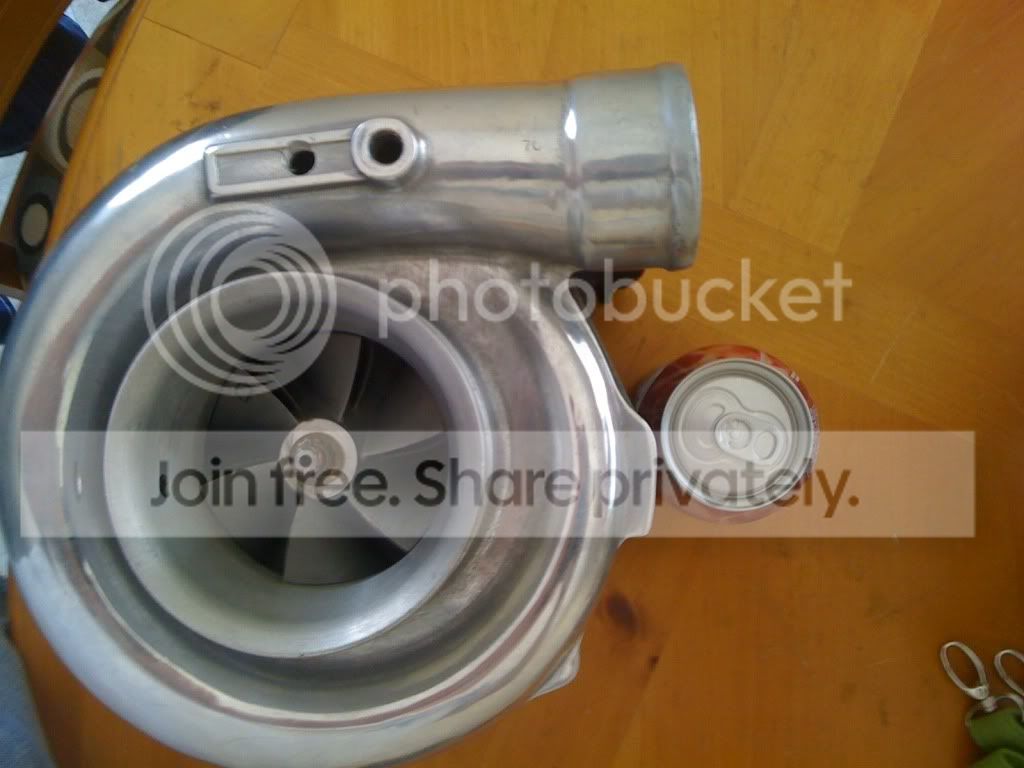

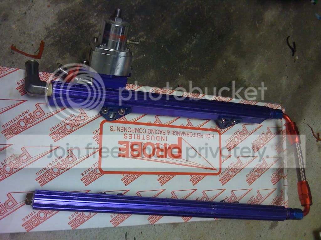

Some of the new parts that will be installed!
Getting put on a diet!
The new intercooler good up to 1200hp.
The new 76mm turbo nice and polished!
As of right now the block is at the machine shop getting bored and notched for the new 383W stroker kit with forged H-Beam rods, Forged 8 to 1 compression pistons, and forged crank.
