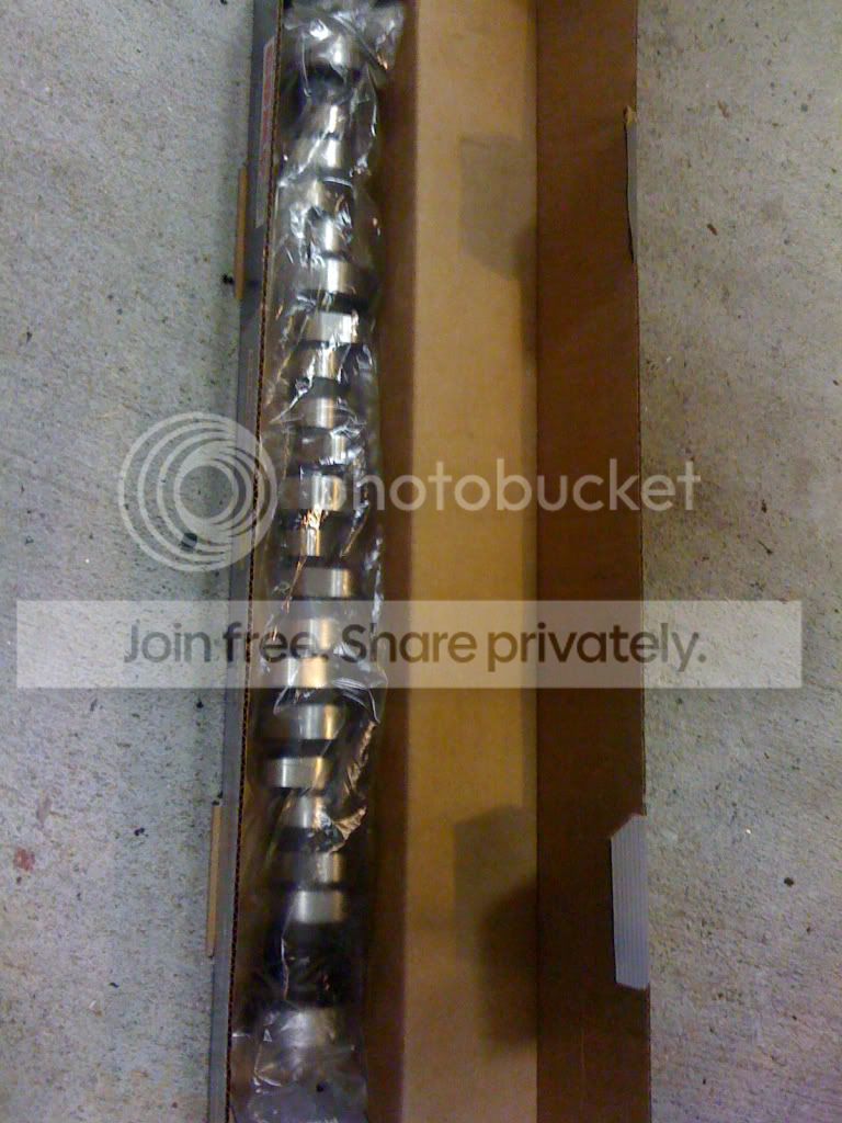

got my new custom grind comp cams camshaft today.

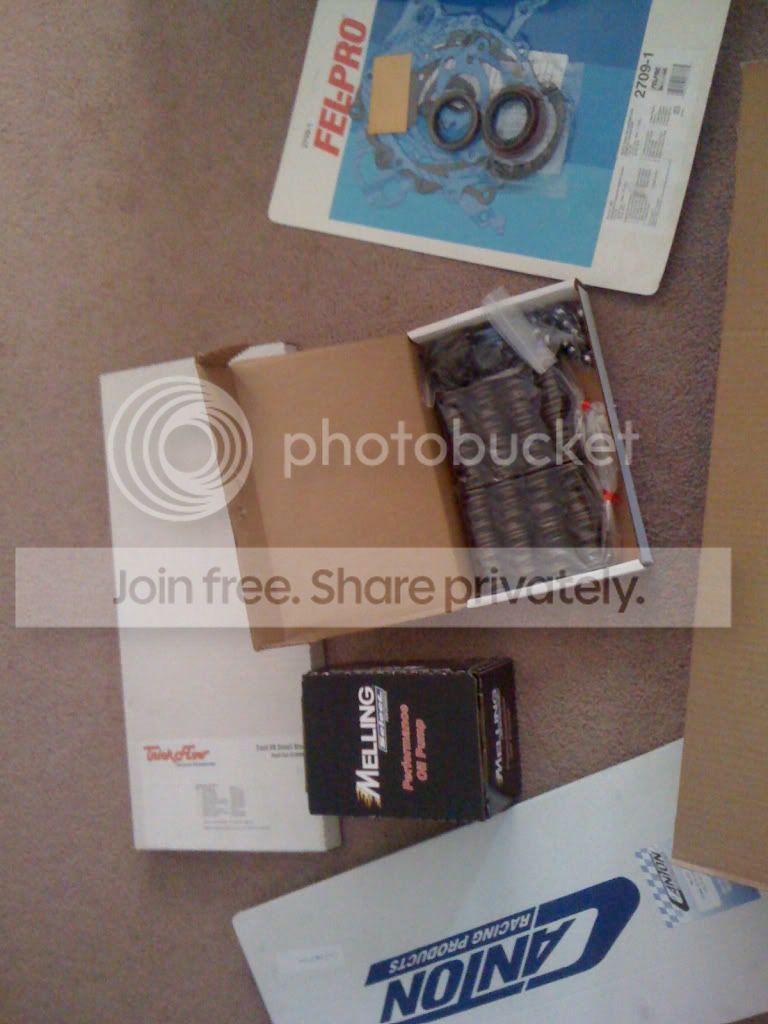

Got some new parts to add to the pile waiting to get my eXtreme X forged pistons, and H-beam rods from DSS racing should be here next week so I can take my block and internals to the machine shop.
My new Custom built clutch
Merry christmas from SUMMIT RACING to me.
