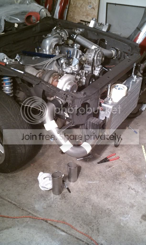

Mocking up the new cold side...went 3" diameter instead of the original 2.5"...New intercooler as well (4" thick vs. 2.5")

Thanks guys! Yeah, needed to step up to the 4" intercooler to be a little more efficient. The last IC was ok for the original turbo (Precision 67mm) but once I stepped up the the PT88 I'm sure it was causing some power loss.
