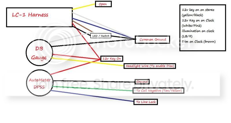

Just encase anyone else is wiring up the same basic things here is a small diagram to help:

Its been a while but I'm pretty sure I got my wideband power from the convertible top harness on my coupe...
