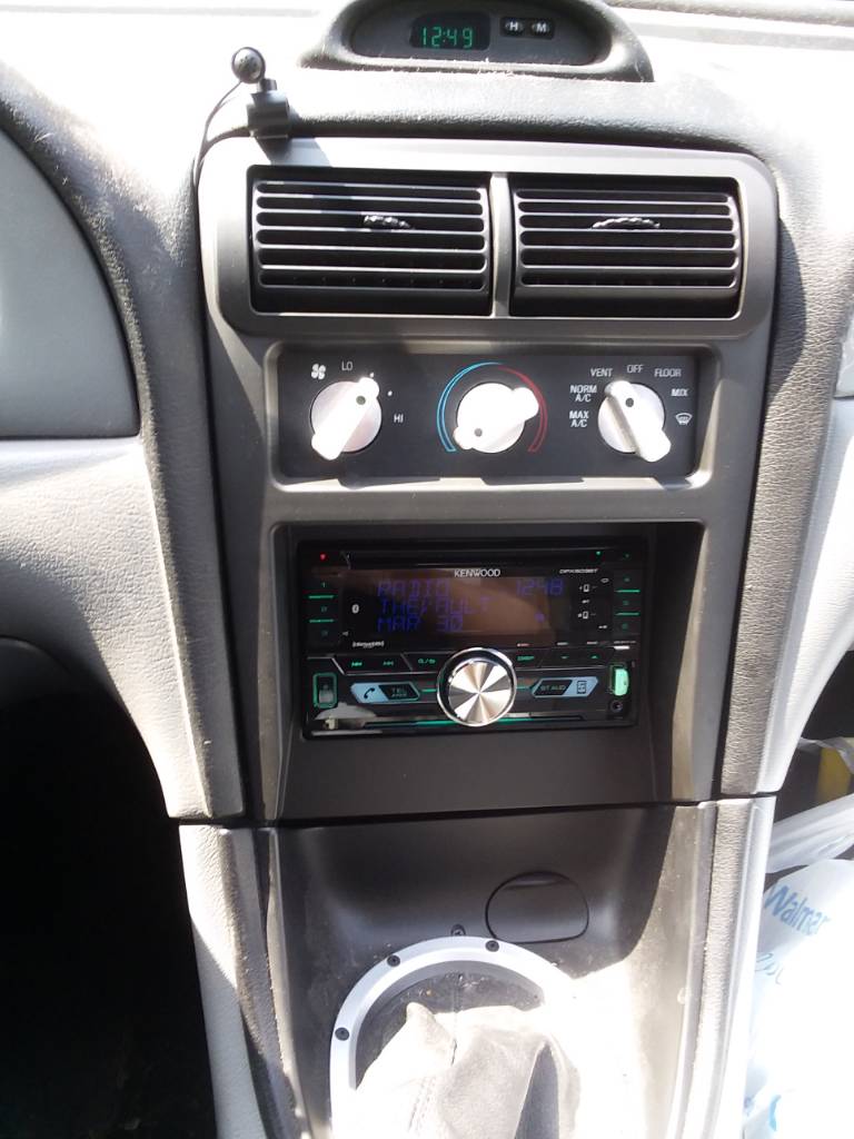

Ok, got some pictures, I don't know what the deal is with the misalignment on the lower right side above the shift bezel. I'm thinking it may be something with my dash panel, because the radio surround matched up with the original, so I need to look into that. And, yes it's black, not charcoal, pics were taken on Sat. afternoon in bright sunlight, and are washed out a bit.

Damn, I didn't realize my dash was that dusty, even has cobwebs, LOL:confused:. Anyway, I want to let you know what I did wrong, so that anybody who wants to use this kit doesn't make the same mistakes I did, the most time consuming part of this job should be the wiring. Use magnetic drivers, I still have one screw rattling around in my console somewhere.
The biggest issue I had, was the Metra instructions aren't clear as to how the brackets need to located on the radio. In the instructions, it looks like the top edges of the brackets and radio should be flush, that is wrong, the bracket should be about 1/8 inch below the top of the radio. I wasted way to much time enlarging holes, and drilling new ones, trying to get the top edges flush. When the brackets are in the proper place, the holes line up. After you have the brackets on your radio, before doing anything else to the faceplate, install the clips and test fit the radio to the faceplate. It should be centered in the opening, and the brackets should be tight against the back of the faceplate. If not loosen the screws and adjust. After this is right, the rest is just follow the instructions. I used a razor saw to cut off the ears in the opening, I think one of the "jab" saws, that uses a hacksaw blade, would work also. The plastic of the dash is a very ridged reinforced plastic, so do drill pilot holes for the screws.

Hmm, interesting, I was of the understanding that the 94-00 shifter bezel was different from the 01-04, and wouldn't work with the later radio surround, I guess I understood wrong.
in the 2nd and 3rd pic the right side is not lined up. The bezels are similar but there is a slight design change that if you are not picky you can live with it but if it bugs you it bugs you.
I lived with it for about eight years. Then I got a matching shifter bezel, and it really didn’t improve the look much. (My cigarette lighter door broke, which was the real reason I chose to buy a replacement.) Even with the replacement fitment is still a bit off. The bottom of the radio bezel still needs to be trimmed, as it pushes down on the center console.
One thing to consider about the metra product though is how awkward it looks without buttons. I would definitely buy a placard of some kind to put there. With the 01+ bezels, you can use buttons, which I use for aftermarketing lighting and heated seats. Also, this, like the 02+ do not have the vent closures on the side. This always bugged me. If you want to continue using directional vents, the way Ford originally intended, you will need a factory 2001 bezel. I rarely use AC, but when I do, it’s typically for someone else. If they want/need it blowing at full. I want the option of closing vents, and aiming them elsewhere just creates a bouncing effect.
