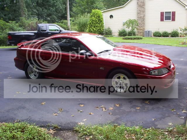

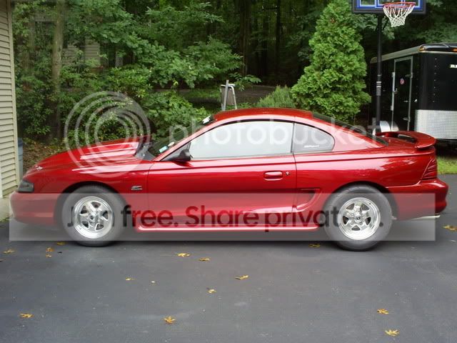

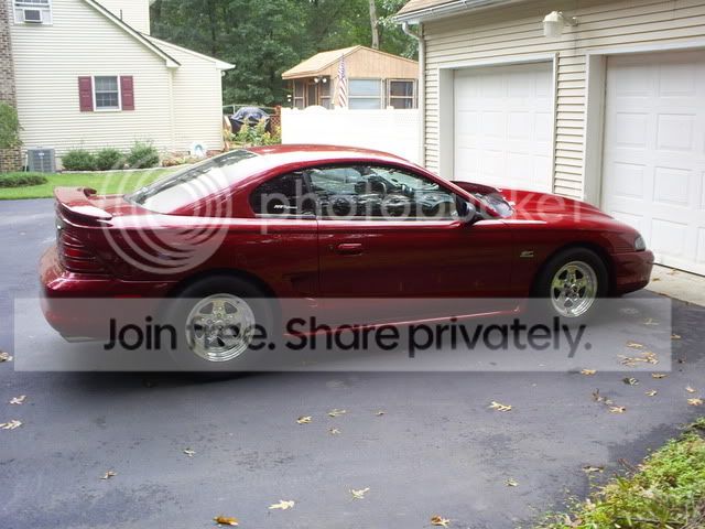

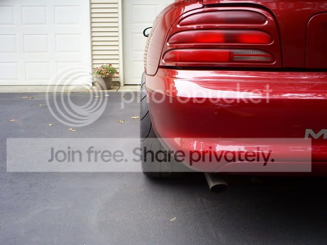

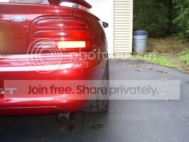

Well I got a new set of wheels for my car, Jegs star wheels in 15x4 and 15x8. I love how they look aside from some simple problems. I thought I could get away with stock studs on the fronts with a 5/16 spacer, but the studs dont even make it to the end of the open ended lug nut. But worse than that, my driver side rear wheel sticks out about 1.25-1.5 inch more than the left. It looks ridiculous and I don't know what to do about it. The wheels are the same and it didn't do it with my old wheels. Anyone know what could cause this?

the one side sticking out more than the other is a normal thing..you notice it moreso when you go to a bigger tire than with stock or skinny wheels. And my studs on my spacers are that big either for my skinnies. You should be fine.

Switch the wheel that sticks out farther on the driver side with one on the passenger side and see if you get the same thing. That will determine if the rim has the wrong backspacing (packaged incorrectly) or if the problem is as DFG said, something that is typical and more noticeable with wider rims.

Moroso makes a direct press in stud for the front, I had to get some for my 97gt when running spacers. I would just measure the back spacing on the rear wheels to see if they are the same.

Looks good on there, unless the tires are different widths, it's your rear suspension.
the stock 4 link can push out 1.5" under a load. you may want to change your LCA's if they're still stock.

I have aftermarket control arms and nothing seems to look bent or out of the place. It never looked quite like this to me until I put the new wheels on. I have a picture of my car with the 03 cobras from only 2 weeks ago at an NMRA event and nothing appears to stick out. The car hasn't even barely been driven since then so I couldn't have broken anything since then. I am sooooo confused...... :rant:

i have the same wheel set up but mine are not the jegs they are welds and i use mcgaurd shank style the ones that slip through the wheel itsrld with the washer ..i use spacers as well and have no issues?? maybe im not understanding the question however..and the rear i could only figure the wheels have different backspacing
