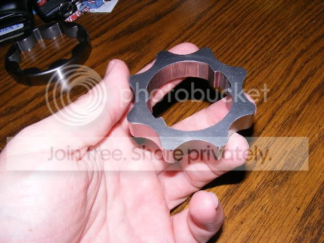

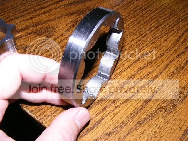

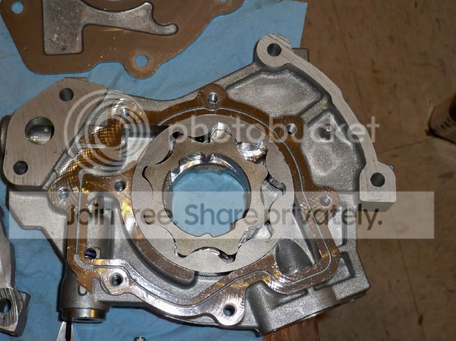

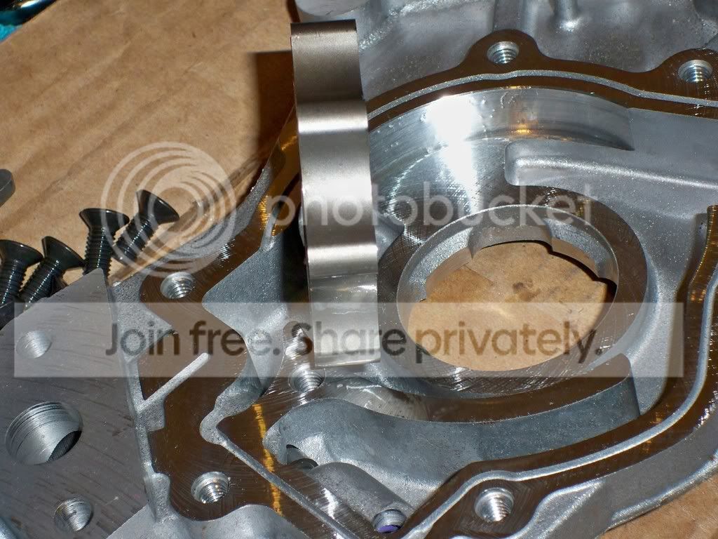

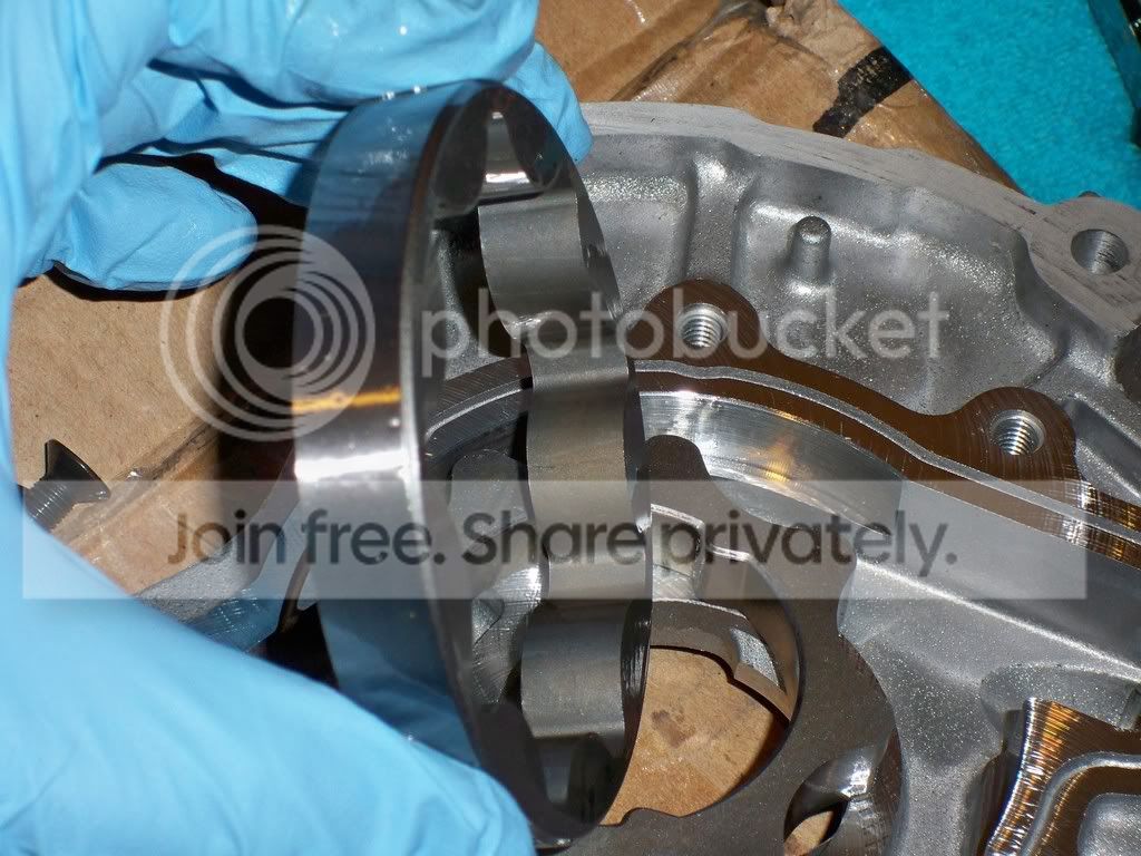

here is a TSS Billet Oil pump (very nice piece)
Facts:
Melling Pump Specs:
Pump to cover .002
Tip to Tip .004
Pump to body .010
Inner/outer gearset weight 1311g
Stock pump specs:
Pump to cover .002
Tip to tip .004
pump to body .005
Inner/outer gearset weight 1077g
TSS gears in stock new 2V oil pump housing:
Pump to cover .003-.004
Tip to tip .005
pump to body .002
Inner/outer gearset only weight 295g :thumbsup:
