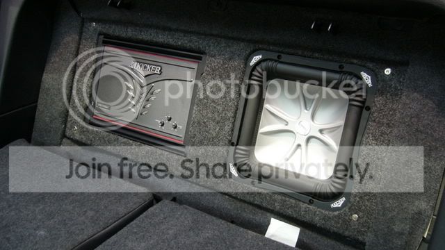

TxCobrA98
May 14, 2006
7,976
forward facing FTW
i have a port in the back of the box (facing the trunk/license plate) and the only thing that RATTLED was the license plate frame against the plate itself. i installed the license plate Dynamat kit and it got rid of all the rattling. 14 bucks and it weighs about as much as an xbox controller or something.. it weighs like a pound or less.
