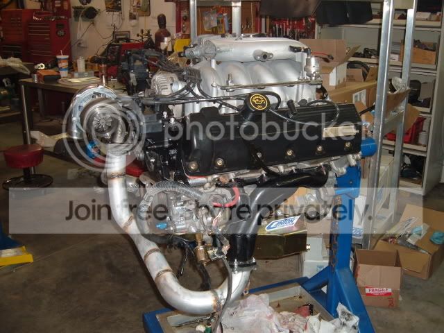

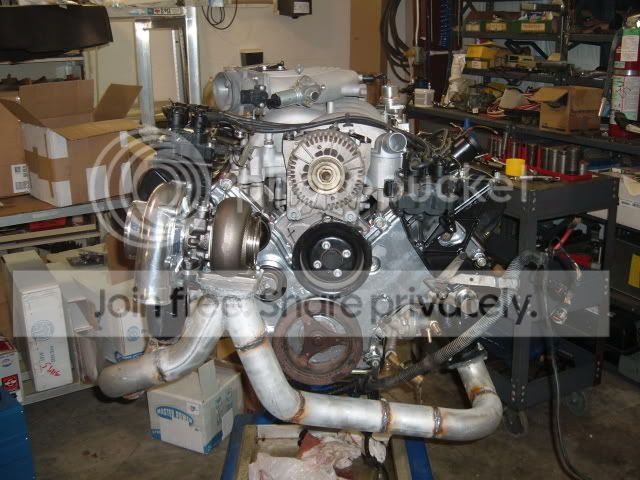

I should be right about 9.5:1 as it is now. Do you happen to have any pics of your setup? Who's hot/cold side did you use?

That looks great man, can you shed some light on your setup/numbers/etc?
Oh man... Thats asking alot, i built that car Almost 10 years ago! Lol. The gist was:
FRPP aluminum block
MPH prepped cobra crank
Forged rods (forget the brand)
diamond pistons
P&P PI heads w/ comp hiload springs
MPH turbo cams
P&P Bullit intake
single blade TB
90mm Lmaf w/ maf extender
kooks turbo headers
Master Power T70 w/.96ar turbine
2 1/2 hotside, 3" downpipe
4" core intercooler (biggest i could find to fit between the front bumper supports)
60# inj.
4- 255lph intank pumps
-10 fees to a Y, -8 to the rails
-8 from rails to Fuel pressure reg, -8 return to tank
Tial Wastegate
TurboXS BOV (i think)
i never got to put it on the rollers before i sold it, but the buyer said it was a solid 550-600rwhp car when he bought it (which i agreed with) that was on 14psi. I never got the boost controller installed for the 25psi race trim i planned to run.
