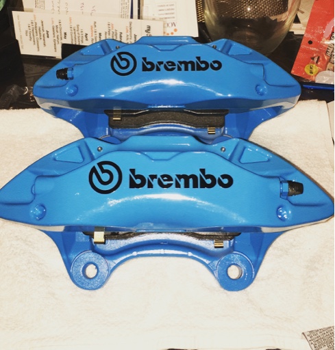

You all are comparing apples to oranges. All the other Brembo calipers are smaller pistons that are the same size in the calipers, look hard at the pics you have posted, Brembo makes lots of calipers that fit and you are thinking they are all the same. The real GT500 calipers are stamped FoMoCo on the back with IIRC 52mm piston and a 48mm piston. Look at this pic and you can see the pistons are differant sizes.
Look real hard at the back, different size pistons, stainless cross over tubes not mild steel.
These have 44/40 Pistons!
Everyone is comparing apples again your numbers are off.
Piston Diameters inches (mm)
07-12 GT500: 1.73, 1.57 (44, 40)
13-14 GT500: 1.50, 1.34, 1.18 (38, 34, 30)
2015 GT PP: 1.417, 1.417, 1.417 (36, 36, 36)

You are right, but the early ones have the biggest pistons for the smallest rotors. Go to the Bob's racing website and tell me what the brake torque is per rotor diameter. The 2015 is odd having 3 x 36, all the same size, I was told that the different pistons prevent shudder and uneven wear?
