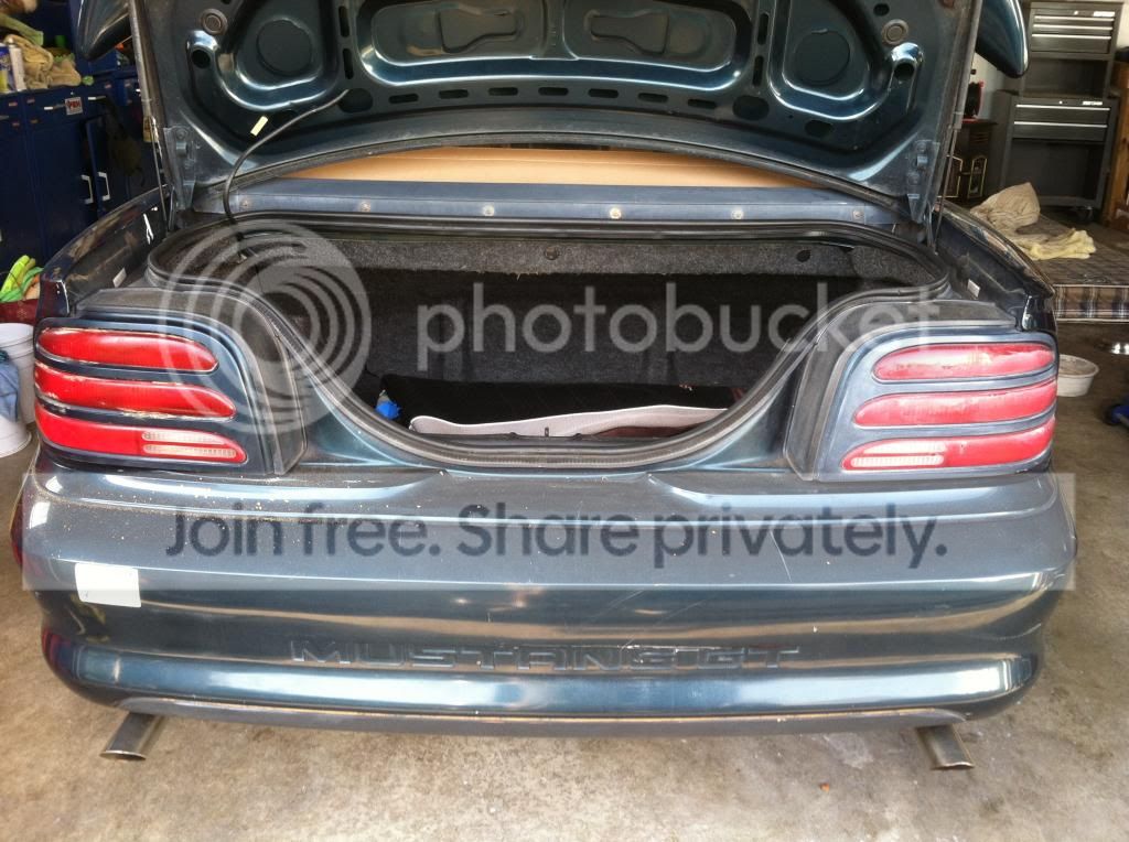

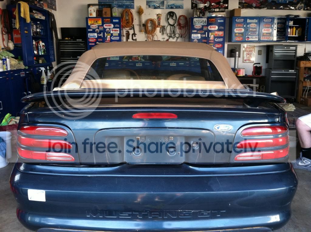

Well we got the car home and I had pulled it into our garage and noticed how terrible the taillights were and couldn't take it so I decided to restore them, kinda set a deal with myself that if I could surprise my brother with them he would save his money and not go for the 96-98 taillight swap. Sooo off I go! Don't mind how dirty the car is...do mind that you can see the new tips as well!
I had already started working on the left one but they both looked like the right one when it first began!
This was just after a medium cut used with an old school mothers-ball
And finished product...
Plasti-Dipped Spoiler
Figured out a plan for the rear of his car since his spoiler has little clear left on it, my brother decided he wanted to go with my idea of having a black spoiler, taillight housing, bumper inserts and rear bumper valence...the majority of that is coming soon!
And for all the hate on the rusted out exhaust....
Boom.

The tails look great dude, I need to do mine soon. Did you use compound on em?
Thanks man! I did a medium cut compound, a light 1500grit wet sanding, swirl remover, polish, wax :)
