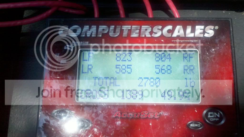

Don't you have a truck scale near by, or a recycling center? Those are pretty accurate. You are not going to get the corner balance, but you will get the overall weight, and you can also check front to rear weight distribution, if you just put one axle on the scale.
Bullitt5339
May 30, 2010
396
Looking good. I weigh mine all the time and check the crossweights every time I do a suspension change. It's great to have a set of Longacres at my disposal. This was when the battery was still in the stock location, moving it equaled it out perfectly.

Man, if I were at 2780lbs, I'd be pretty darn happy. Car is drag setup?
