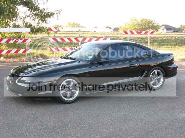

the new look! took some fresh pics today. its on step 3 of 147, so there is a long way to go. I know it looks like every other black mustang out there but just wanted to share my new project.
i love the low look, and wingless. I think it really accents the classic mustang look of the long hood and short decklid! i love it!

Step 3 of 147 - I like that :santa_smiley:
Looks good man!
You gotta tell us what your plans are!!
cobra4978
Apr 16, 2007
1,153
looks great man. I love black especially done the right way and yours looks great. Wouldn't mind knowing a some of those plans you got for it!
SMOKE
Mar 20, 2006
675
A person with a plan .... gotta love it.
Good starting point.
CruizinKev
Oct 17, 2007
1,129
very nice!!! 8)

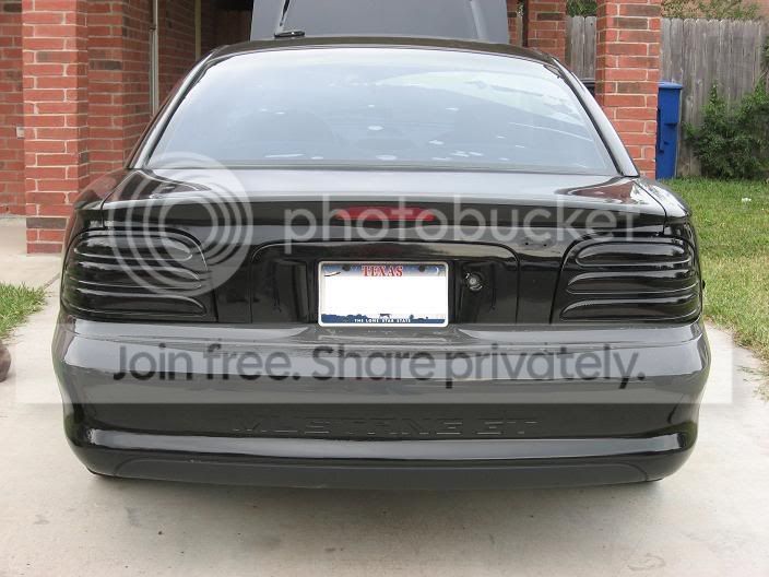

awesomeguy6154 said:
very nice! howd you get em smoked like that? ive been wanting to do that to my 96 but i have no idea how
my buddy Paul has the hook up...his painter does em...adds a little black paint to the clearcoat then sprays em. looks good. but sort of dark during the day. night time visability is fine for cars behind me. I will be swapping in some LED bulbs to enhance then brightness/visibiltiy during the day
