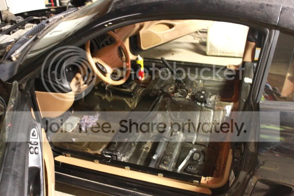

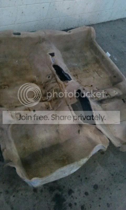

Stripped the interior and pulled the carpet. Man that stuff was nasty! Went to the truck stop car wash. I socked it with some TuffStuff cleaner, sprayed with high pressure soap, scrubbed with a tire brush, and then rinsed FOREVER! It actually doesn't look bad. Plus, it was free! There was close to $10 in change through out the car after I got it apart haha!

BEFORE:
AFTER:

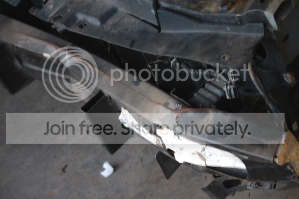

What I found after removing the front bumper...

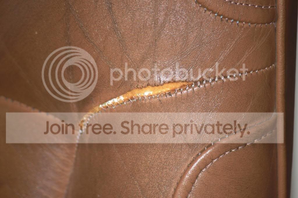

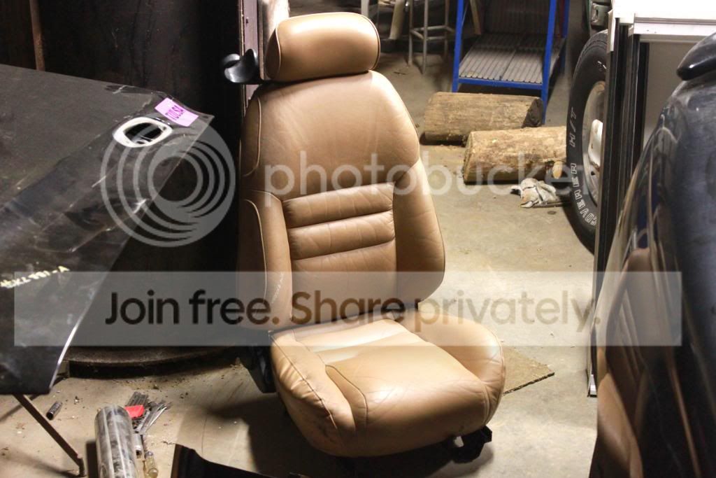

Split on drivers seat. If it wasn't for this I could easily re-dye the seat and make it look great

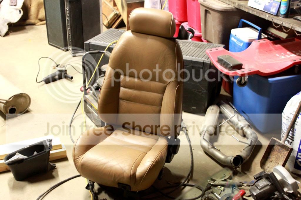

Driver seat
Passenger seat

Cleaning the filth out of the interior while its apart

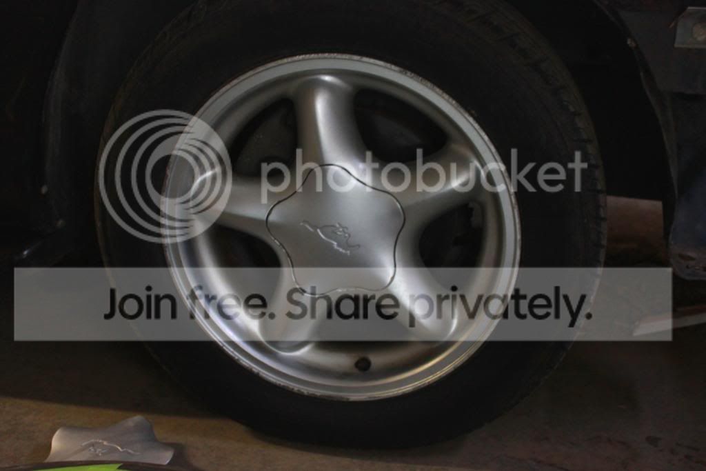

Factory wheels are kinda beat up and have paint flaking off
So Im sanding them down and repainting them

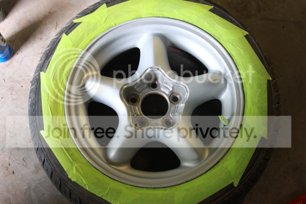

Primed with etching primer
And painted with some silver wheel paint. Color is actually close to factory. Going to paint caps aswell

that front end is not too bad, if the core support isn't too bad, You can pick u p a new bumper reinforcement aftermarket for 40 bucks, styrofoam absorber for another 40, and header panel for ...you guessed it... 40 bucks. those steel accordion folding things are also pretty cheap. For the body parts check craigslist, there's always somebody selling a black fender for under 50 bucks. Good luck with the resurrection!
