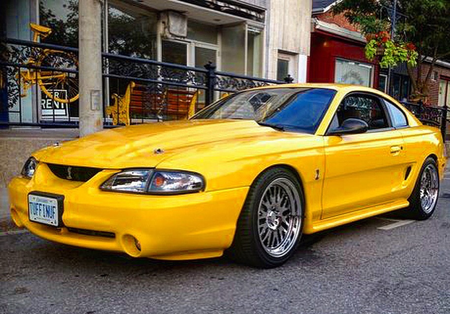

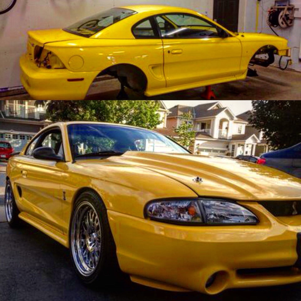

Hello, I am about to install a kenne bell blowzilla on my 1995 5.0. The car has ported gt40 heads (with ARP head bolts and fel pro 1134 multi layer steel head gaskets) ported gt40 lower intake 1.7 crane (cobra rr) xe270hr camshaft, custom cai, 70mm maf and throttle body, bbk unequal length headers, magnaflow stainless catted x pipe, flow master 40 series catback.
I will be fabricating an intercooler setup for the kenne bell.
I am looking for advice, information or installation photos I can find.
I do not have installation instructions so if anyone has a set I would happily purchase them or a copy
This is the car where it began and where it is currently

Just a heads up, i noticed the 1.7rockers with a 270cam. Having positive pressure behind the valves may cause some upper rpm valve float. Im not saying it will, but keep it in mind. Their may be multiple repeats of this combo and runs mean for all i know.
Asides from that, your car looks great!!!
