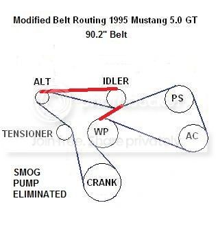

Converting to manual steering, already have a/c and smog pump deleted with a short belt but wondering what others have done for belt routing while keeping the stock style water pump. My searching keeps turning up folks saying they did x-y-z with whatever belt but pictures that have been deleted/moved or no pics at all.

with just a quick look at the belt diagram I would try and find a ribbed idler pulley. Not sure if the angle on the WP would be an issue or not. Looks to be the easiest option w/o going with some kind of additional idler or brackets.

Yeah I'm trying to avoid having the big uggo power steering bracket left over just for an idler. I got a weather break and tried it without an idler though and it won't have enough tension against the water pump at least with stock pullies, might work with larger diameter underdrives.
