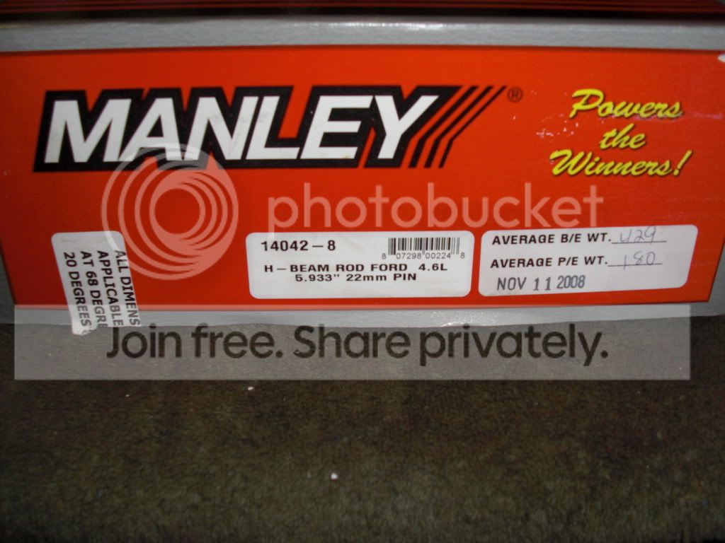

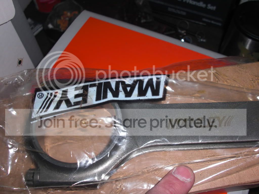

this is to see if any one is interested in buying a fully built motor! its not technically for sale yet but if i get someone interested ill go for it.
i have a 4.6 teksid block with everything new. lower oil pickup, kelloge crank, manley forged rods, and pistons, and so forth. im just going to get rid of the bottom end and the block. i make 357hp / 368tq out back on patiot stage 2 heads and crower stage2 blower cams, with 9 to 1 compression.

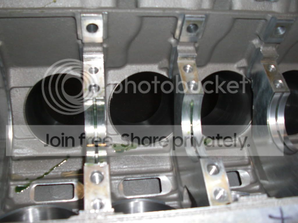

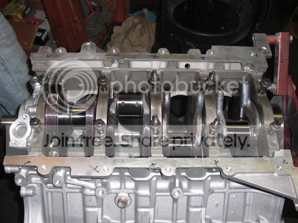

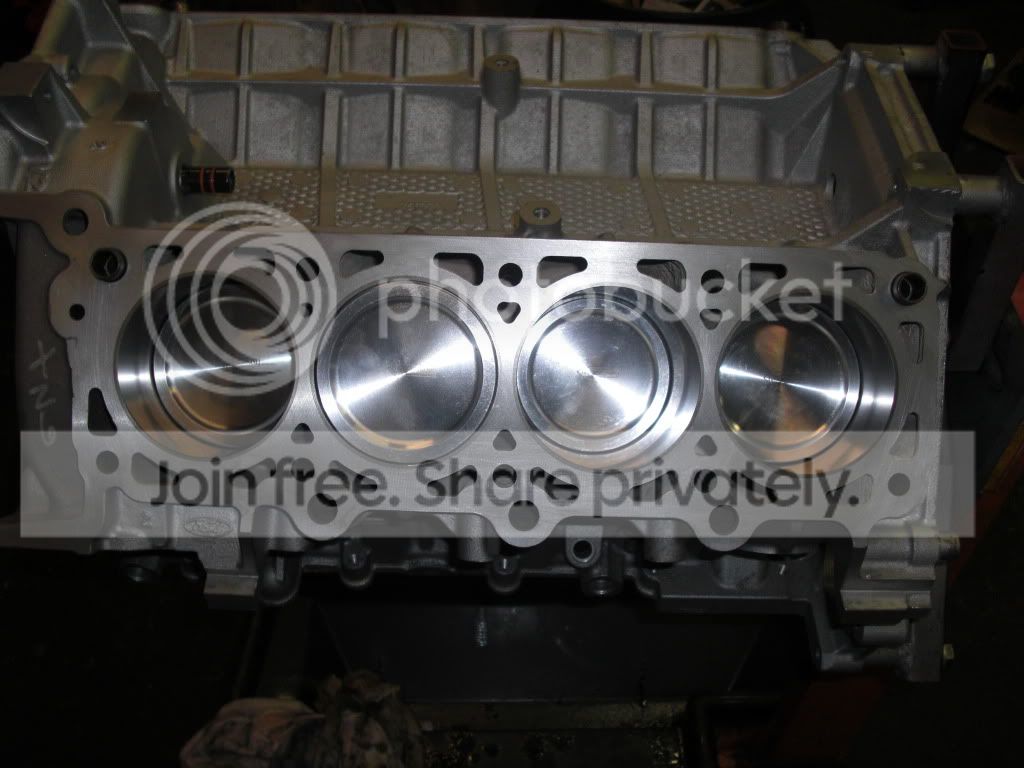

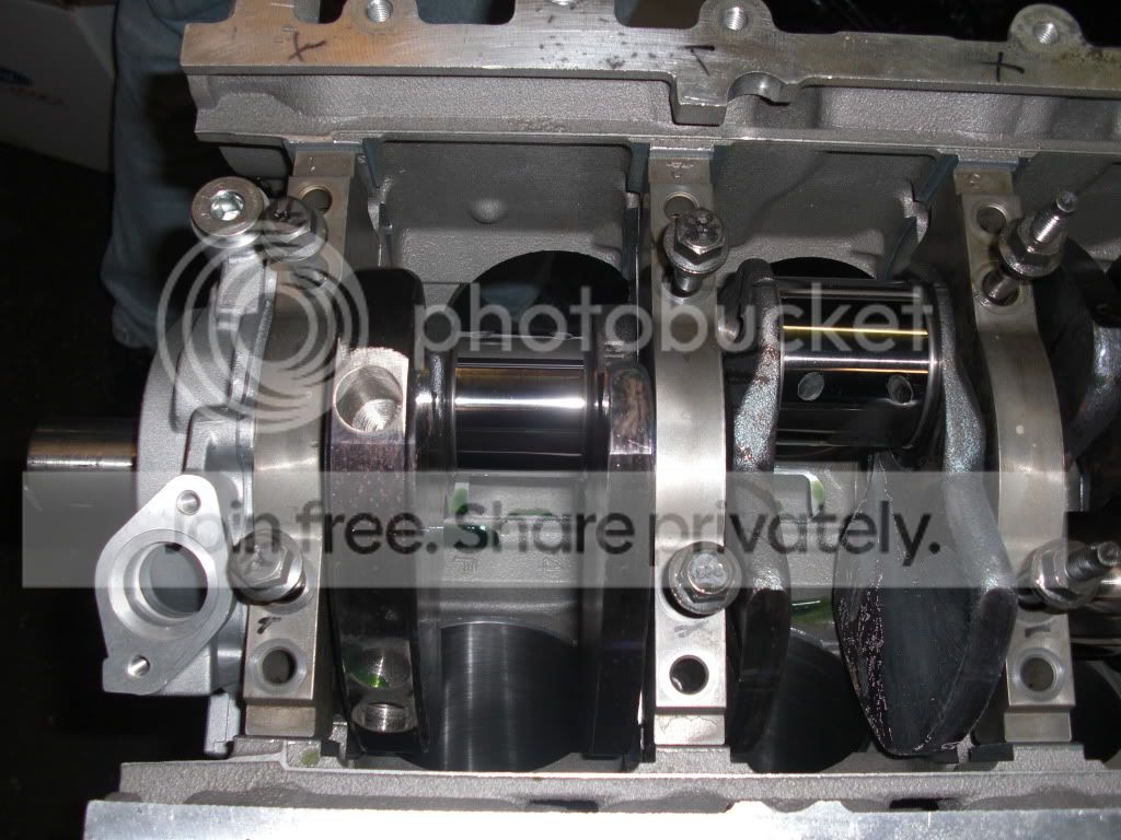

no the one in the pics is a aluminator block that i already sold but the iron block is in the last pics fully assembled. with all the other stuff in the pics in it. i swapped it out and put all the internals in the iron black that is now on the car. i just put those up so you could see how well it was pu together and all the other internals that are in the current set up.

the post is very misleading. i was expecting to see square etching in the valley and i see diamonds. also, if it were teksid the oil pan rails would of been thicker with multiple freeze plugs on the drivers side. in the last picture it still seems as WAP block and not an iron romeo block.
