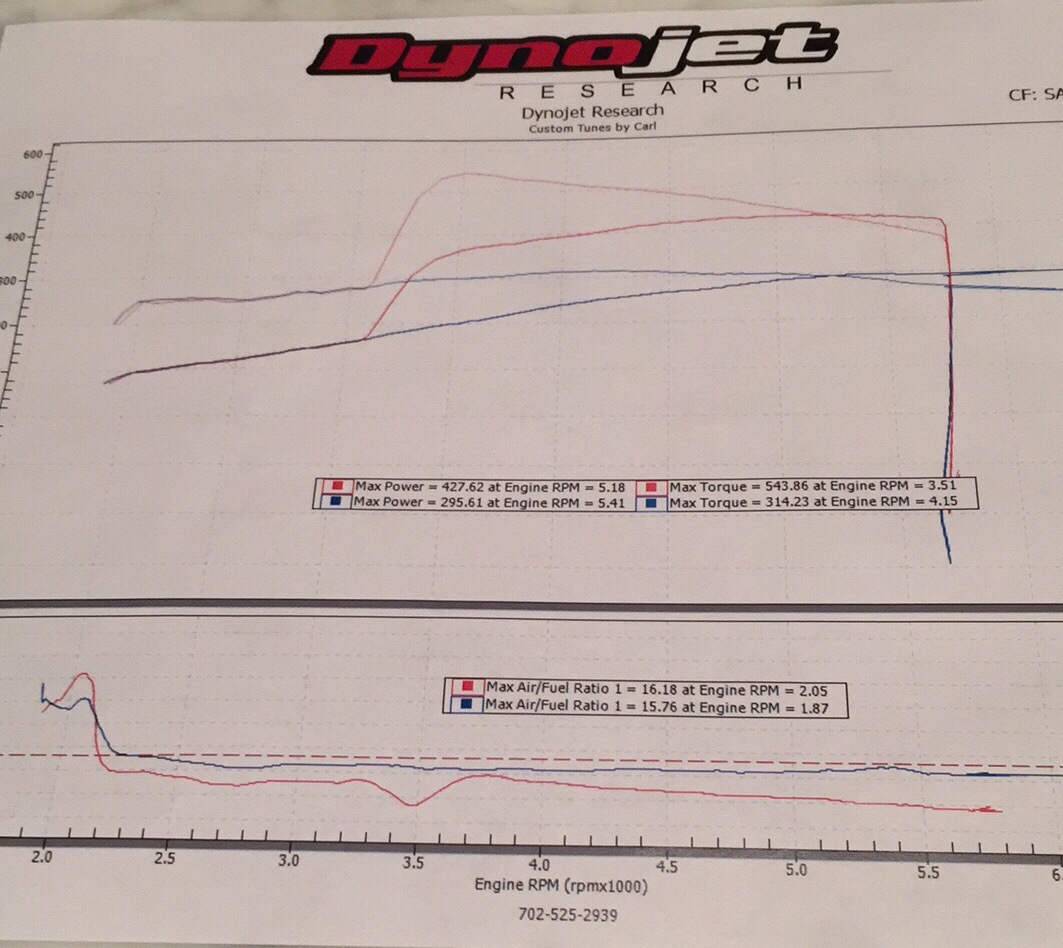

First order of business was the tune. Installed some 39lb injectors. They're bigger than my current setup requires but I had them laying around, so I installed them for peace of mind.
Car put down 295/314 naturally aspirated.
I forgot to mention the power adder... :grin:
Spray bumped the power to 427/544

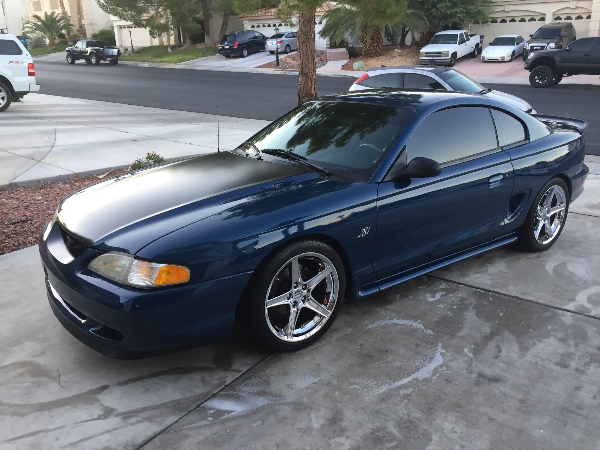

Next I needed to change up the look a little bit. I liked it the way it was but wanted to make it mine.
Installed the XXR's from the Cobra with some new MT ET Streets 305/35's
Ditched the aftermarket 281 badges for some tri-bar badges
Nitrous purge was a plastic tube. Swapped out for a hard line painted black to conceal it

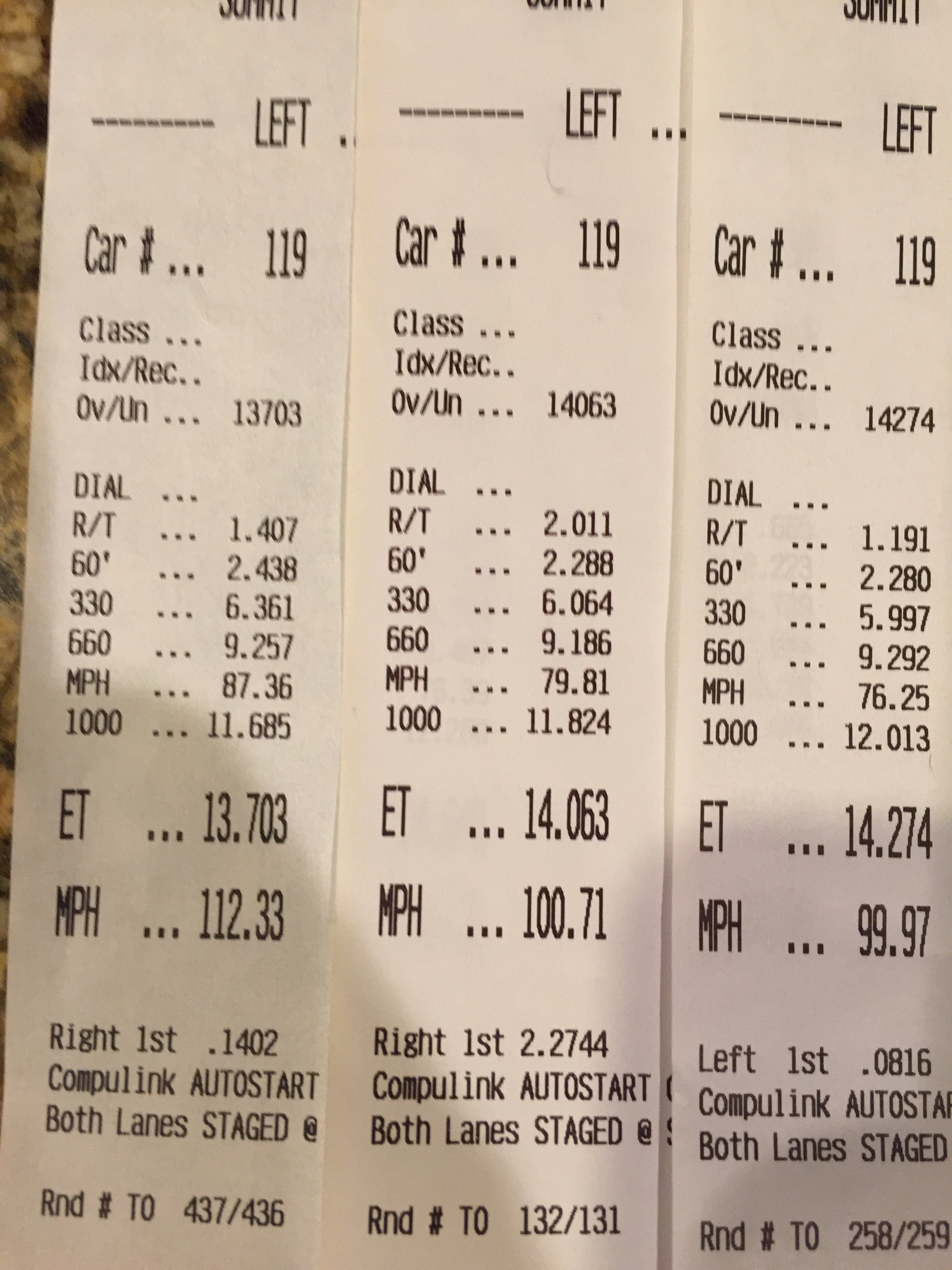

Went to the track for some fun. NA was running 14.0
Sprayed twice, increasing 10-12 MPH, but traction issues caused by bad driving led to roasting the tires.

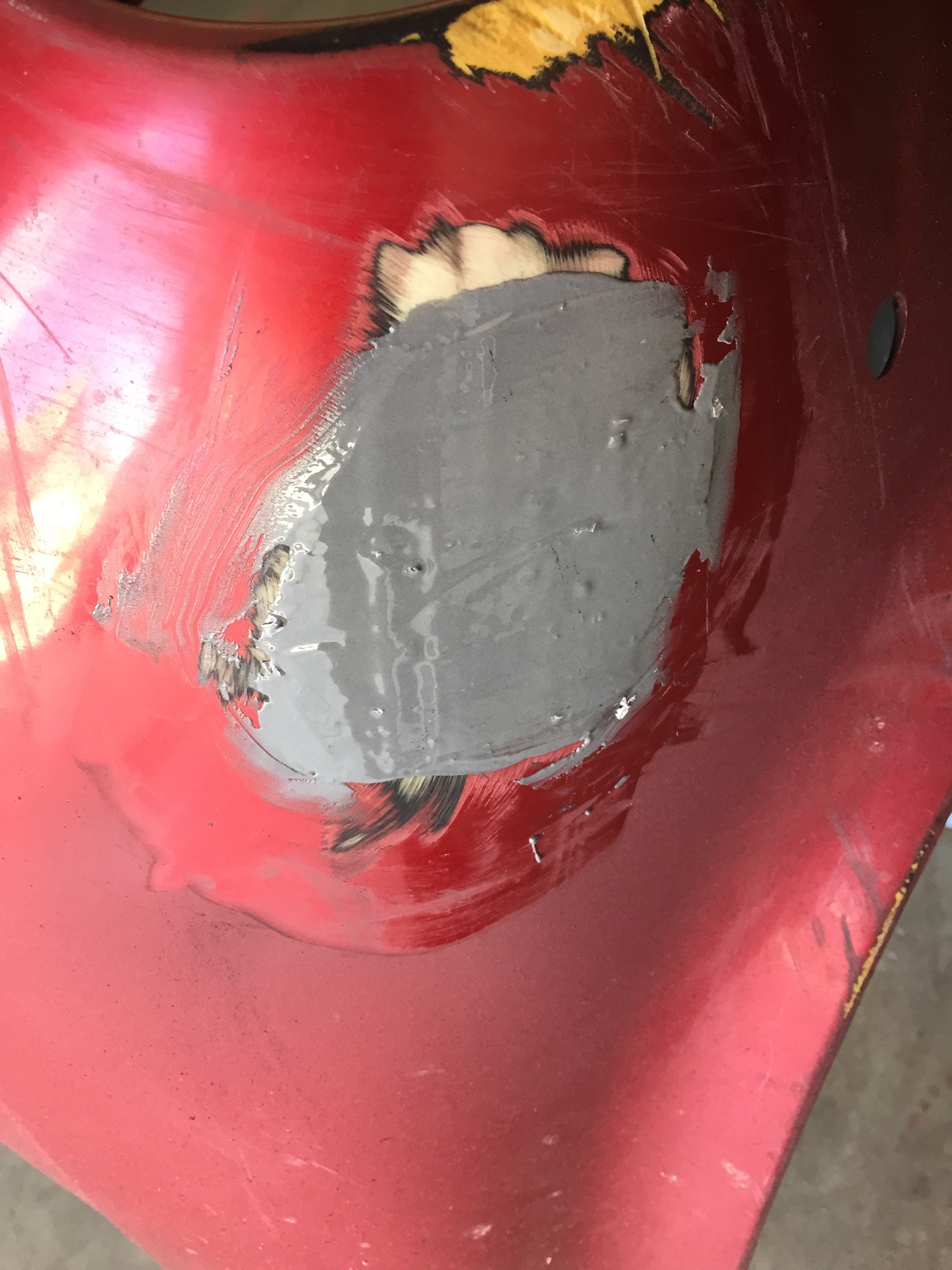

I grabbed a hood and bumper off CL for $270. Great price however they need some work.
The hood has been painted numerous times and has some cracking.
Bumper has some deep gouging and a crack under the fog light
I'm starting on the prep work this weekend. Bought some AB paint for the bumper today
I'm thinking about doing the hood and roof gloss black.

Started prepping the bumper today.
Began with the crack. Took a piece of sheet metal and attached it as backing with countersunk rivets.
followed by some grinding & filler
some more grinding, bondo, & grinding
Used a DA with 220 to sand the whole bumper
Couple coats of primer & a guide coat
