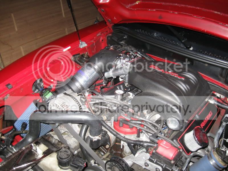

I have a dyno apt today at 4:00 PM. While this comparison wont be under ideal conditions It's the best I can do in my situation. The dyno run's will be just about one year apart but it will be during the same time of year weather wise (first run was july of-09) but as we all know weather can change drastically from day to day let alone from one year prior. Last year when I went the weather was warm and sunny, today is going to be cool and cloudy w/ a chance of showers. I'm bringing up the weather topic b/c as we all know dyno #'s can change based on this so if my numbers are different by not that much we can probably notch it up to that. If not then perhaps there is more power to be had w/ the fox TB set up. I'll list my previous and current set up and I'll post the results w/ a graph once I get back later today.
Previous set up:
PMAS 95MM Velocity meter, C&L pipe, Edelbrock/BBK 75MM Throttle Body,
Dyno numbers at this time, 338 RWHP 342 RWTQ
Current Set up:
PMAS 95MM Velocity Meter, Anderson 4" Power Pipe, Accufab 75MM Thottle body
Dyno Numbers : Pending......

I did pull more HP/TQ but over all the test is moot b/c I was able to pull 2* more timing then the last time so the HP increase was effected more by that then the TB swap. The car was VERY lean on the first pull. He had to cut it short at 4,000 RPM's b/c it was up it the 15's for A/F. He wiped the tune out and started over, made some adjustments and adding some timing and the final results are below. Before it pulled 338/342. It gained some up top and most of the RPM range over the previous graph.
Current set up

6 HP/5 ft gain..
Like you said, I would say a majority of that is from more fuel/timing. The swap probably didn't give you much of a gain BUT it does make life easier with a fox TB design. I miss being able to do work so easily on my Foxes.

nothing but Accufab :thumbsup:
I really like how my power does not even start to drop off until almost 6,000 RPM's. Most (other then built for high RPM) Push rods start to lose power by or at 5,500. I credit mine to the Ed Curtis Camshaft and the TFSR Intake :notworthy:
