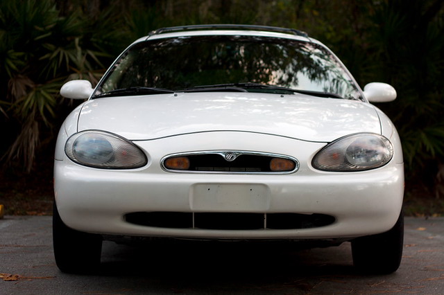

cleaned up the car a bit. basic car wash and vacuum until a full cleaning happens this weekend.
Headlights restored from yellow nastiness
before on the left and restored on the right.

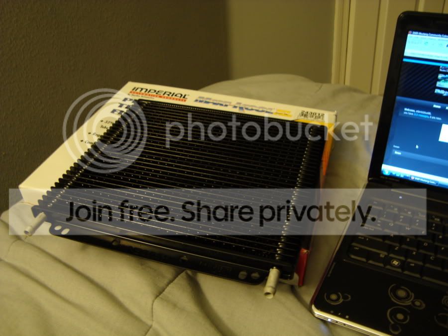

again, at Advance Auto, picked up a nice little present for the AX4S tranny. A Hayden Maxi-Cool XL transmission cooler.
this size is meant for RV's. i think it'll do fine lol
and a pic next to the laptop to show size
installation is for Saturday morning, i bet it will be fun...

Good jolly damn thats a big tranny cooler. Where are you mounting it?

in front of the A/C condenser, the general spot for coolers.
there is already an Auxiliary Trans cooler stock, opposed to Radiator based like mustangs. but it is really small.
i will be removing that and installing this in it's place. most likely will need to modify the stock cooler's mounting brackets to fit this one
