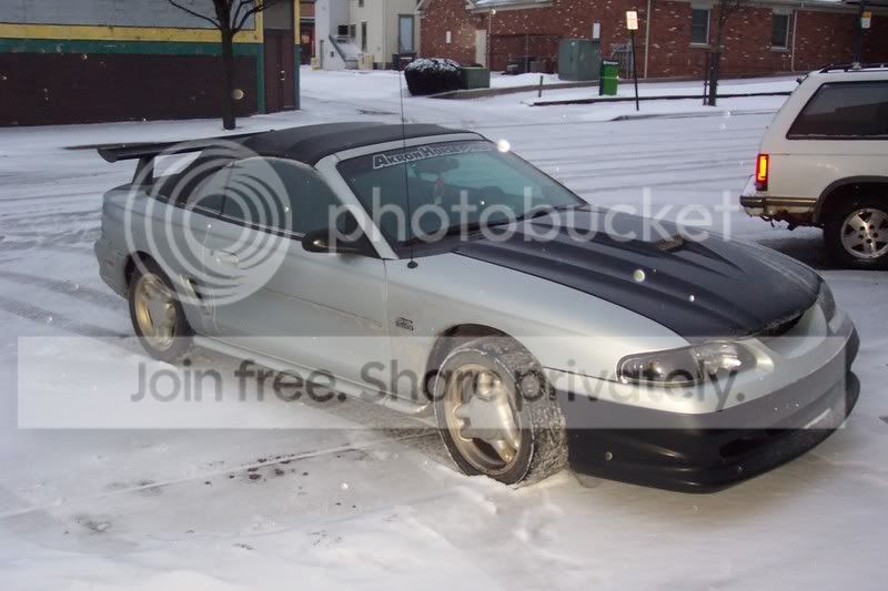

im sitting on steeda drag springs and you can see in th picture i have what the car looks like and my tires are 25" tall, but my car has also been stripped for weight reduction so that also make a big difference on how low or high the car sits
stang94X
May 16, 2007
720
this is the only pic that i could find at a some what of a side view, this was last febuary, same suspension and same tires has i have right now, but the only weight reduction that was done in this pic was no back seat, no spare tire and jack and in the front are aluminum heads, i'll take a pic of the car later of how the car sits with all the weight reduction that it has now
