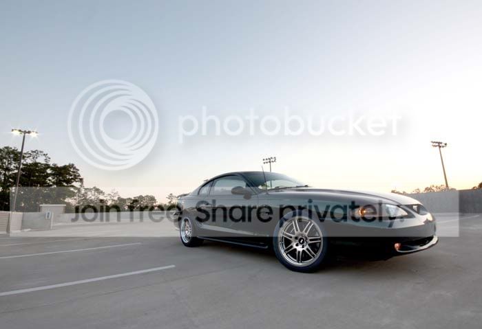

#1 SVE Bronze wheels
What size would be right 17's or 18's? Right now I have H&R Sports Springs and I'm affair that the 17's would look to small with those springs, but also affair that the 18's would raise my car higher and make it look funny and would I have to get spacer in the back if I got the 10.5. Would I have to do any modifications I were to get the wider wheels?
A picture of what they would look like on my car (photoshoped):

id go with the sve wheels, u alreadey have after market exhaust but u got stock wheels, go with the wheels u wont regret him

18" wheels
you can run 18's and maintain the same height, you just run a 40 sidewall instead of a 45 sidewall

I love those wheels, and since you already have a nice (better then the LM's lol) exhaust, i'd say go for wheels.

I'd go with the wheels, you shouldn't need any modifications with the 18's. They shouldn't raise the car either, if you get the right tire size. You might need to flip the quad shocks if you go for the 18x10's, but the same could be true for the 17x10.5's as well.
If you can afford the higher cost of tires go for the 18's.

Wheels. If your roads are crappy I would do 17" wheels so you get a better ride and have a little more sidewall to protect the rims.
