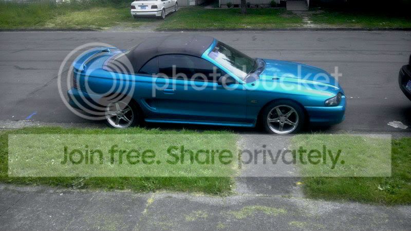

I just installed MM CC plates, X2 balljoints (without spacers) tokico struts and shocks, steeda bumpsteer kit, and some new quads.
car already had 2 inch drop springs.
after everything was done and the car was on the alignment rack, we noticed the front swaybar is pushed up to far and is binding up making a popping noise. for now it is unhooked, but i would like to get shorter end links and install it again.
does anyone know where i could find shorter end links at??
