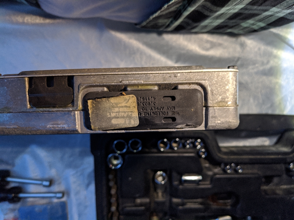

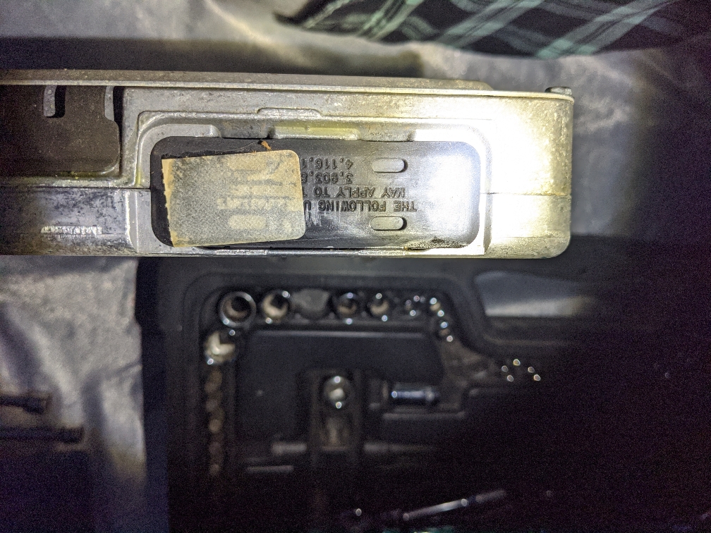

Here's the ECU

Doesn’t look like it’s ever been opened. Take the cover plate off and snap a pic. We’ll know 100% then.
This for sure ^

I thought the chip hung out of the case a little bit but its been a while since I saw a stock ecu. With a stock tune being adjusted for the huge injectors by a weighted maf I would say to start there. Either sell the injectors/maf combo and get something more in line either with what you are doing now or get the supercharger you need to justify the big injectors.
