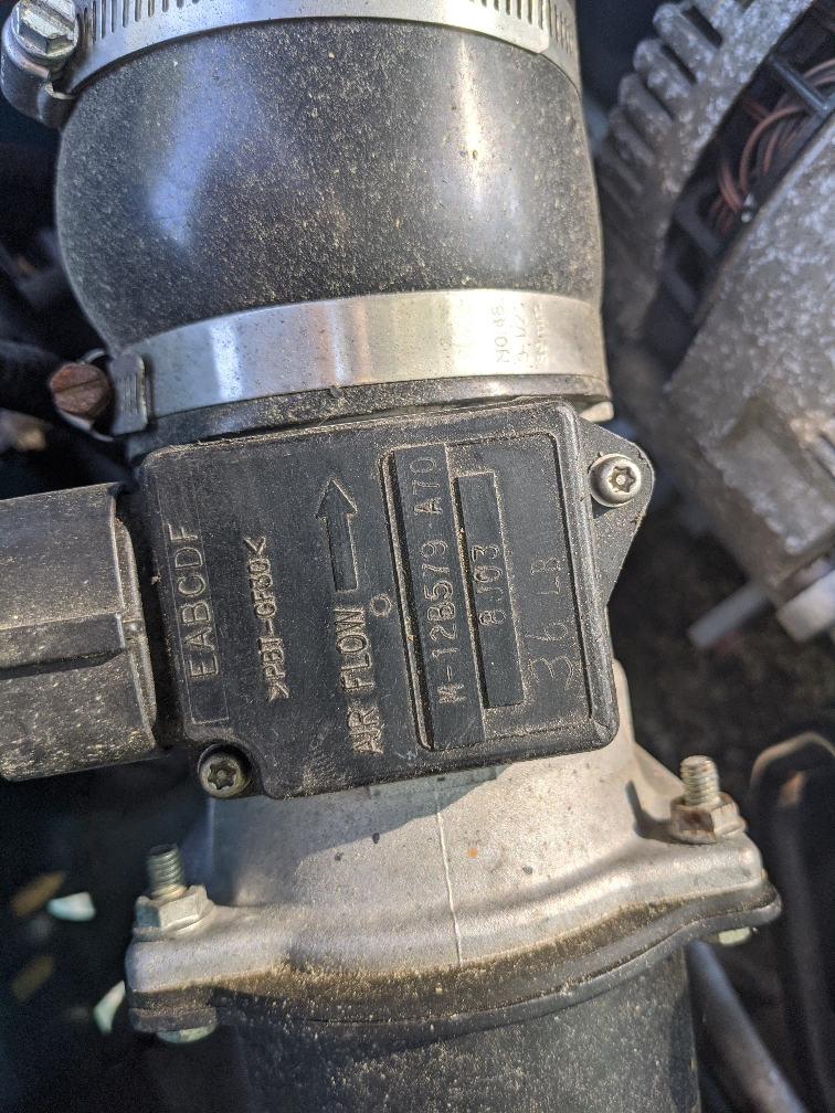

I really think the 36lb is just too big. You have a little more than a cobra motor and they run 24 lb so %50 more injector I just can't think is a good thing. What maf is on there?
