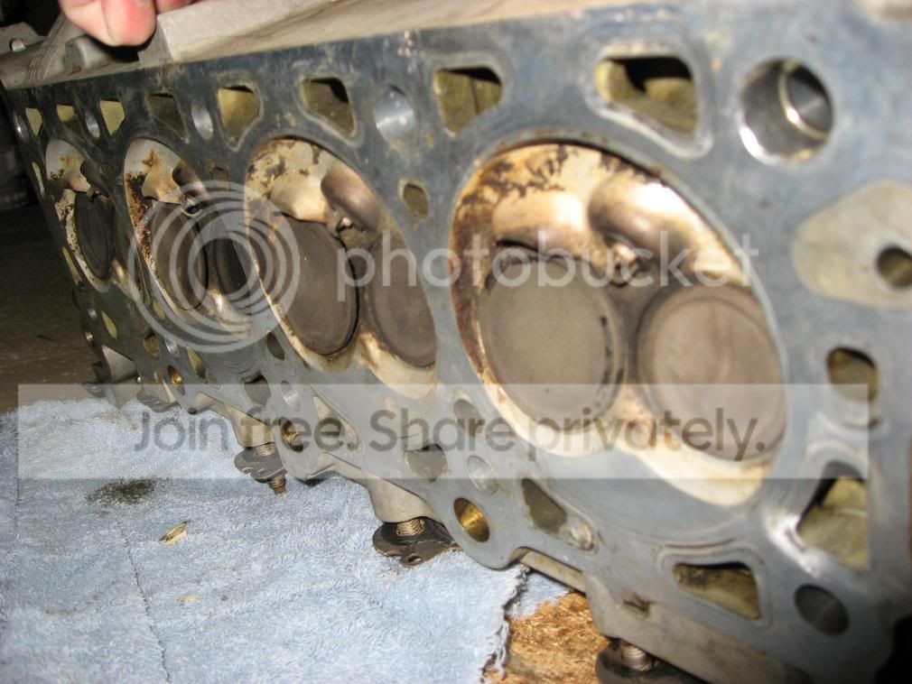

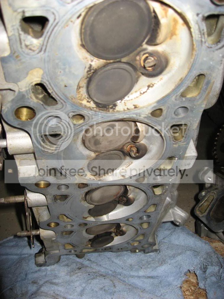

Got them both off and cleaned them up a bit with some carb cleaner and some shop towels. Need to keep going though.

Oh, and I forgot to mention, my friend decided he would try getting some gunk off with some 200 grit sand paper. He only got a couple strokes in before :tickedoff:
It left marks. Not by any of the ports, but still, they're there. Should I just get them resurfaced?

Lol, try to polish them back up and check them with a straight edge and feeler gauge. Gotta love friends, lol.
