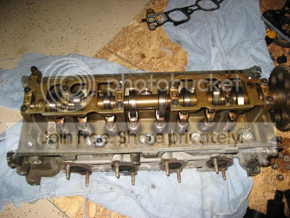

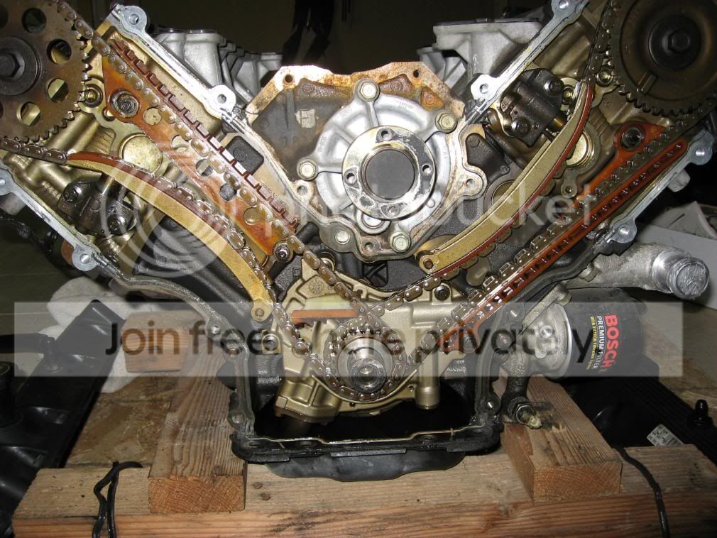

Hey,
So I've been slowly working on getting stuff together for a PI swap. Long story short, I now have a complete 02 GT motor. I got it for $100 from a friend :D He said it made a ticking noise and had low oil pressure after warming up. He thought it was a spun rod bearing. Note the broken chain guide in the second pic- the rest just came off (didn't have to loosen the bolt to get it off). Could this cause his symptoms?

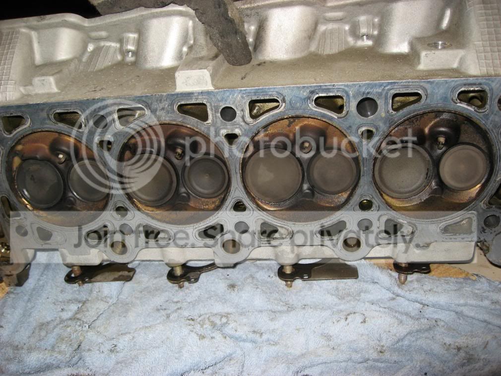

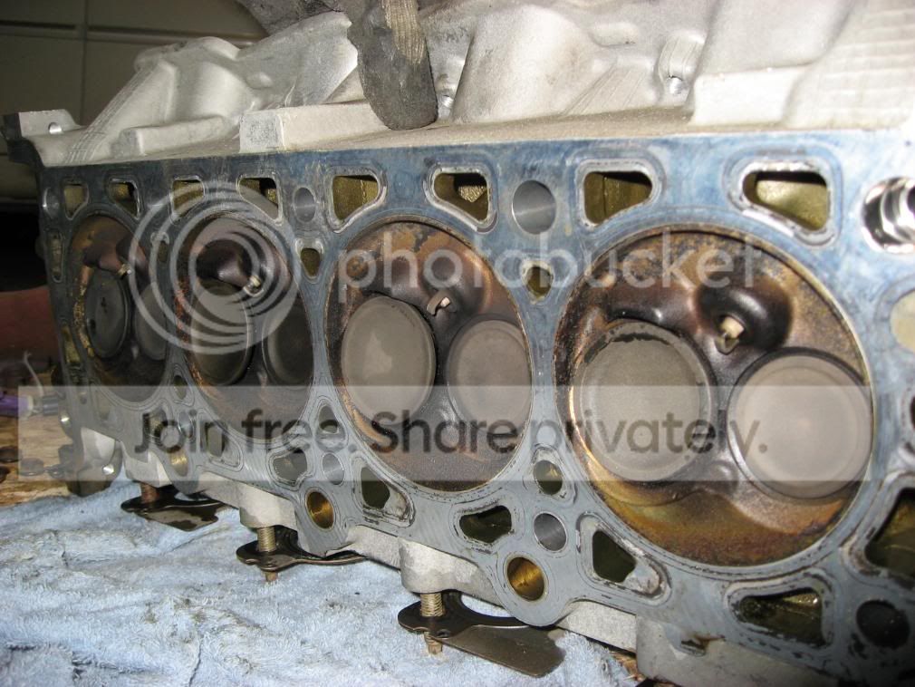

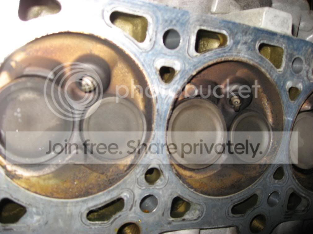

Anyway, I got my hands on an impact gun the other day so I had some fun getting stuff apart tonight. What do you guys think of the condition of this head? (I'll post up pics of the other one when I get it off... gotta figure out what to do about that oil spilling out)
Jrgunn5150
Jun 29, 2007
12,273
The timing guide would cause that, yes. As for the head's, they look like they need a tanking, and pressure test at least.
H
humjaba
Jan 31, 2008
86
Alrighty thanks. They should be fine then, considering the car ran perfectly before the ticking sound began?
voidfinger
Dec 16, 2006
3,880
looks good to me, the heads look in good shape... not a lot of carbon or ash.
H
humjaba
Jan 31, 2008
86
Cool thanks for the help guys. I know I can use carb cleaner on the intake ports- will that also work on the under side? (sorry, i'm not up to date on all this technical jargon)
voidfinger
Dec 16, 2006
3,880
the poor boy's way to tell if the valves are ok and the seats are ok is to put water in to the ports and see if it runs out around the valves... also, you could fill it with carb cleaner and let it sit to take deposits out.
