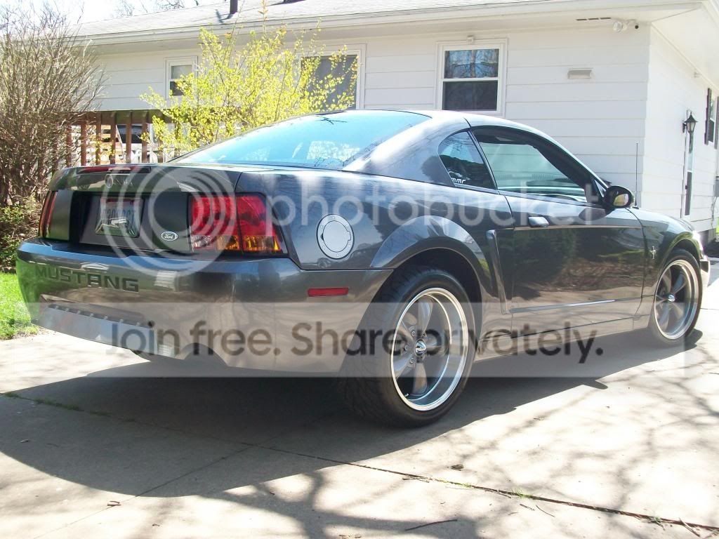

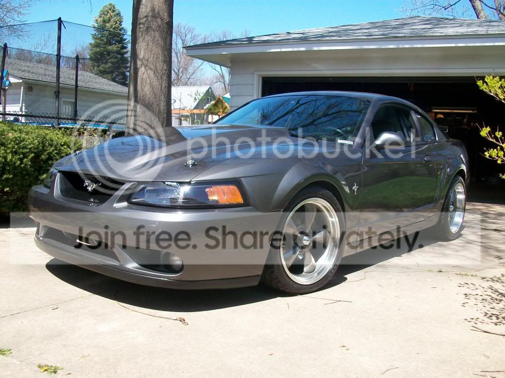

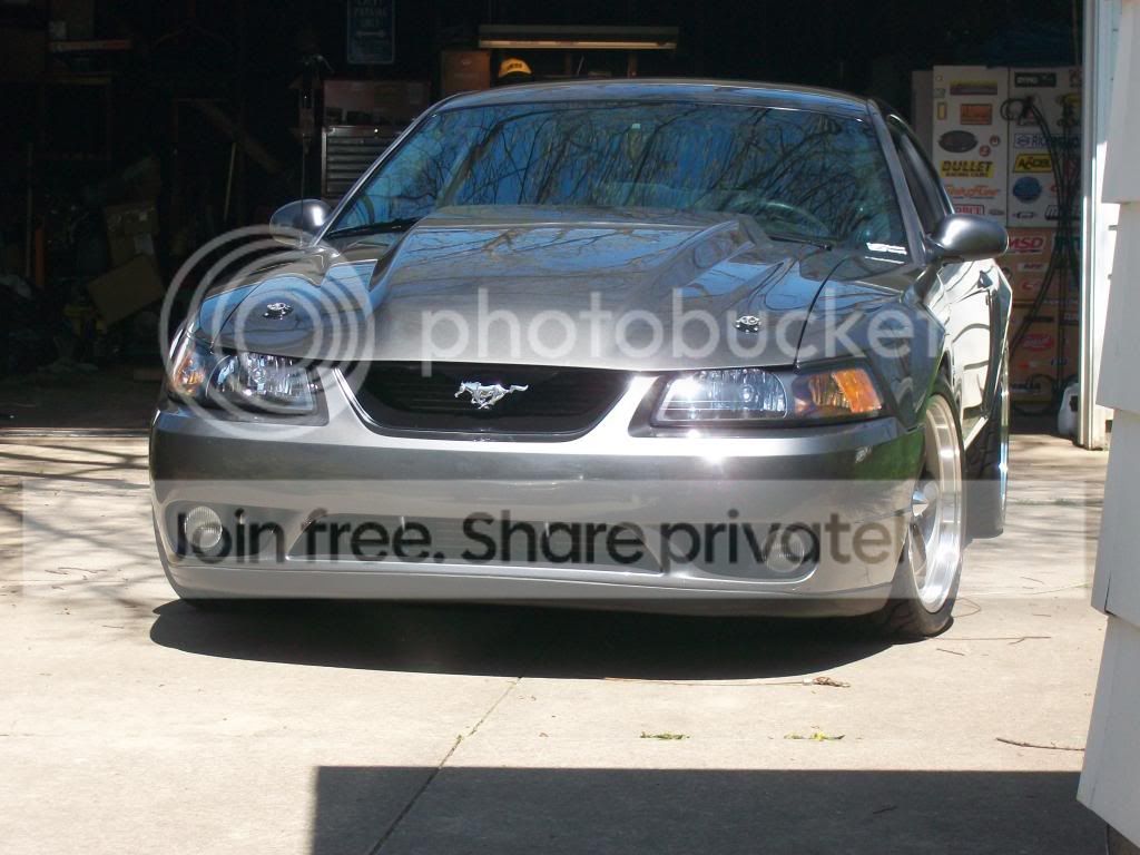

Heres a couple pics of the car running for the first time. I started noticing the tick getting worse as I was taking these pics
Heres how the car sits now. About 2 weeks later from the first set of pics and its back in the air with no drivetrain
