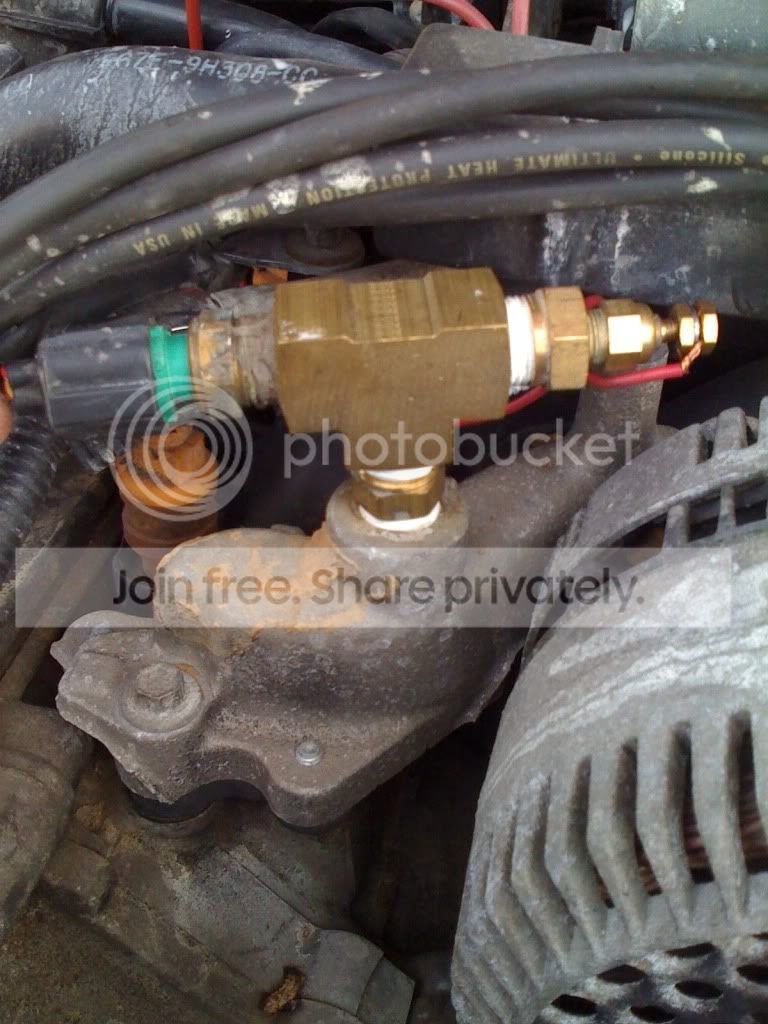

I will get a picture of how mine is set up now, and show you how I am going to do when my intake is off next time.
junior897
Jun 30, 2010
41
Here is a pic of the way I have it now. Wow I really need to clean my engine.
my plan is when I have the intake off over the winter to have it tapped in the center of the crossover for the sending unit.
