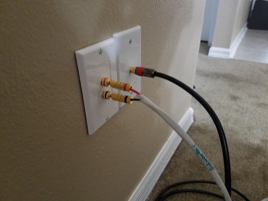

Next, I finally got around to running the surround sound. It was cool enough the other night that it was actually colder in the attic than in the house so I didn’t sweat too bad.
I did a bit of future proofing while I was there. Some subwoofers run on positive – negative wiring, some run on a coax. So, I ran both over to where my sub sits.
The whole system is done up with 14 gauge wiring.
Now the last step will be to add an electrical outlet behind the TV, which I should be able to do pretty easily because there is an outlet I will tap into in the bedroom that is behind the wall. There is not one located in the same room that would work conveniently.
I also ordered a 6 fan system with a thermostat for the entertainment center which should help to suck out some of the heat and hopefully preserve the electronics – should be here tomorrow.
The nice thing about doing it all this way, if I want to change speakers to higher quality later on, it’s a matter of unplugging and plugging in, very simple.

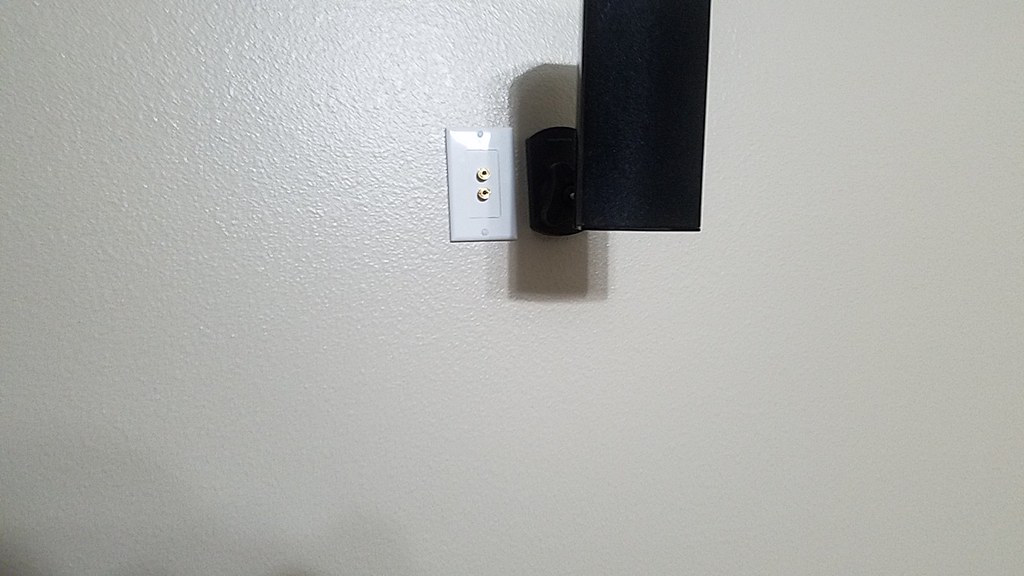

I initially mounted the speaker upside down. Meh.
The couch is pushed off the wall in this shot. It’s pretty much dead center between the speakers now that it’s up against the wall.
This is a 7.1 plate, but I only ran 5.1 at this time. I don’t really have a place for the other two speakers. Though, the Onkyo receiver I have can transmit to those speakers as “other room” speakers so they play the full range, instead of the surround noises. But, I doubt I will ever do that at this house.
This is what I mentioned earlier. The subwoofer RCA cable to Coax, or the option of using it as a +/- sub.

And what kind of subs are you looking at that run off of coax?!?!

I have to admit I am not as up to date on home audio as I am car but I have never seen a home audio sub using a coax connection. I have read where some amps like a signal cable made like coax vs a twisted pair but it still had an rca end on it either way.
Can you rotate those rear speakers in to help cover the terminal plate and wiring?
They make cables for it that are RG6 on one end and RCA on the other. In this case, i bought a keystone jack with a female to female RCA on one side and RG6 on the other. Then I bought an RG6 male to RCA male for the other end.
I bought a quad shielded coax. I could have probably found a 50 foot RCA cable, but the coax accomplishes the same task and is acceptable to carry the sub signal. Basically all I've done is make a high quality 50 foot RCA cable with a couple adapted ends.
The rear speakers will probably change. This setup was expensive when it was new, but Onkyo is known for giving you lower quality speakers with a top notch receiver. But, like I mentioned. The major advantage to this system is now if I want to upgrade speakers it's easy to just pop them on and off the wall or wherever.
If I had a DB reader I could setup each individual speaker to hit the same DB from the "listening position" (center of the couch) but I don't, so I just "played it by ear" (pun intended)
I tried to minimize how much exposed wire there was, which is why those plates are right next to the speakers. I've seen a lot of pro installs do it this way. But there's a million ways to skin this cat.

I see what your doin. When we do custom theaters here we either make custom length rca cables or we do optic. I thought you meant you had seen subs with coax inputs. Lol
Did your onkyo not com with Audysey?? It should of had a microphone that you place in the sweet spot and it adjust the time alignment perfectly
