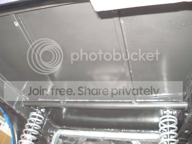

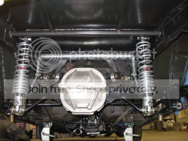

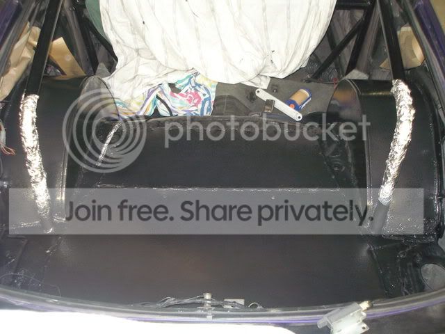

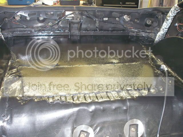

Got a little bit of work done this winter, should be about another month and I can get this bitch rollin!!!!!!
I haven't raced this thing for almost 4 years.
