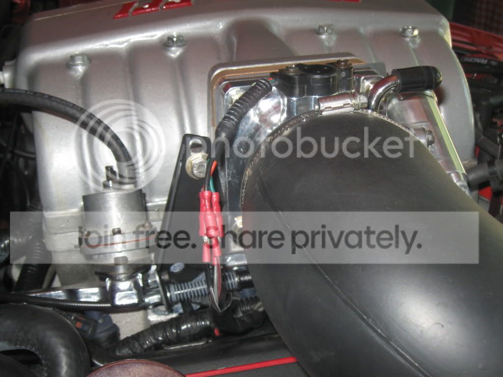

What's up all!! Switched to an edelbrock intake w/ accufab TB, can't mount the bracket. Anybody happen to have a picture of how theirs is mounted? Anyone else put this intake/TB on their car? I have a friend that can make a mount for it but if there's another way to do it, i'd rather not make him machine one. I'll be honest I took it off so long ago i forgot what it looked like before, lol.
Here's a pic:

Are you switching from the 94-95 style? If that's the case you'll need an elbow adaptor or switch to the fox body cable setup

The bracket that was in the car before looks just like an 87-93 setup, it didn't have the elbow that comes stock on the 94-95's
this is the bracket

Let's see if I can talk you through it. In the bracket picture you supplied, The hole on the low right ( furthest away from the really big hole)
is what you bolt to the lower left TB bolt hole. IIRC the big hole is what your throttle cable goes into and the hole next to it is where the
cable tab slips in( you'll know when you assemble it). I think the slot is where the cruise control slips into. Hope this helps.

Correction. I see you dont have the spacer/adaptor. You need one. Look on ebay for mustang egr eliminator spacer.
