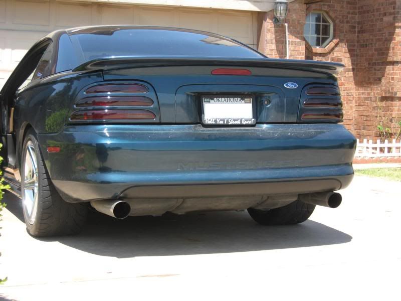

I'm wanting to liven up my tails on my car and have planned on tinting them. My problem is that everyone tints the ENTIRE housing and not just the lens.
Anyone have any good pix of red 94-95 tinted tails with just the lens (where the light shines through) tinted??

I put 2 light coats on, then 1 thicker coat. I didnt wet sand them at the time because I was tired and I just have been putting it off for 2 years...
37,644
7,762
I only did my a touch to keep the functionality and you really don't need much. I went to a local paint supply store and when I told asked them for the VHT and told them what I was doing they said they had something better. They hooked me up with a high quality black candy paint and a uv resistant clear and it came out great. It was only $35 for everything including the tape which was the worst part but infront of the tv it only took 15=20 mins. Be sure to use the clearcoat as it will give a good smooth finish and help it last, mine survived 2 summers in the phoenix heat with no problems.

the only problem with doing it is if you want everything to match you need to do the 3rd tail light and the side reflectors but I love the look personally.

DESERTCOX05, Javi That's what I was lookin for...they don't have to be red...just lighter color cars. Everyones looks great so far!! Thanks!
