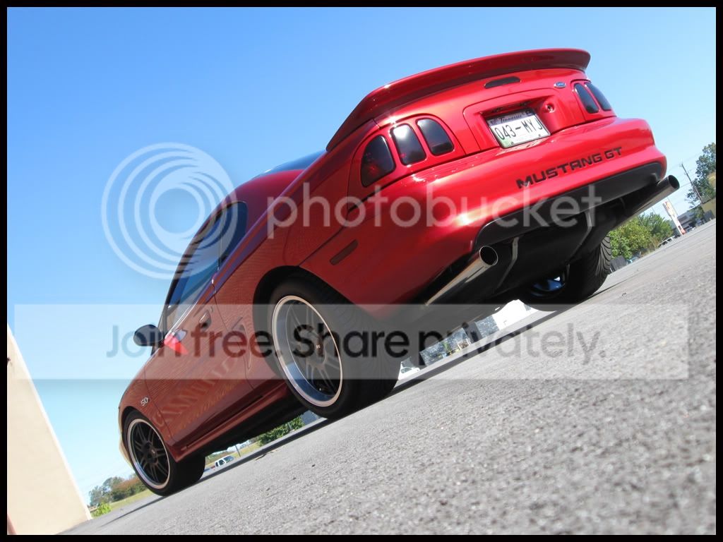

Yep, clearing them will definitely make them shine! Here's mine that I did with 3 light coats of Niteshades, wetsand w/ 1000 grit, 4 coats of acrylic lacquer clear, wetsand w/ 100 & 1500 grit, buff with Megs 105 and 205, both with white pad.
I also did Jon's tails the same way just without all the sanding because they came out so nice after being cleared. We just buffed them with some rubbing compound by hand and they came out awesome. This is also a good example of having the reverse light masked off.
