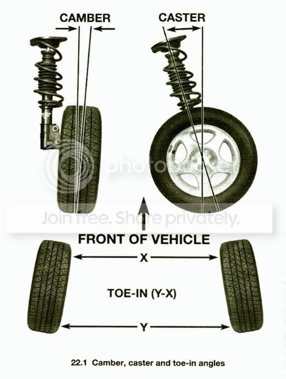

It could be a Postive Toe, but when he gets a alignment they should be able to tell him if they had to adjust the Toe or if it was the Camber. Toe in or Toe out will cause steering instability also. With something that severe i would thing he would be having major problems.
Toe
Toe describes whether the fronts of the tires are closer (toe-in) or farther (toe-out) apart than the rears of the tires. Toe settings vary between front and rear wheel drive vehicles. In a front wheel drive vehicle, the front wheels try to pull toward each other when the vehicle is in motion, which requires a compensating toe-out setting. A rear wheel drive vehicle works just the opposite, necessitating a toe-in setting. Stated differently, toe is set to let the tires roll in parallel (at zero toe) when the vehicle is in motion.
