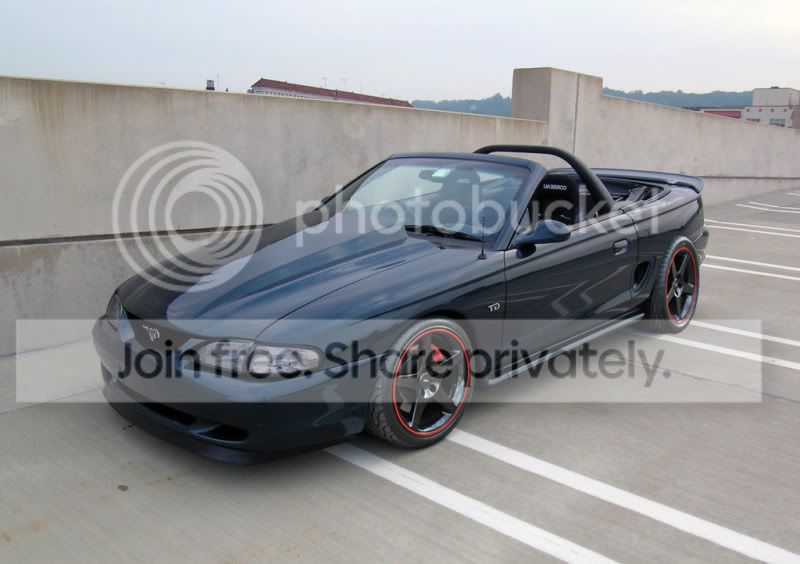

As for exterior mods, I'd say it's lookin great and will look even better with that hood painted and a chin spoiler on there. As for wheels, I have a HUGE vote for either 18" chrome 03's, or 18" black 03's with a red pinstripe...here's a chop I did on Jon's old car...
Not a great chop, but you get the idea...i think it looks menacing.

Great minds think a like! I've been feening over chrome 03's in 18's on this paint code for a long time. I've seen chrome cobra R's on this paint code a long time ago in person, and professional pictures and it looks fantastic. I'm going to try my hardest to pick up the wheels from AFS when I come across some funds.
