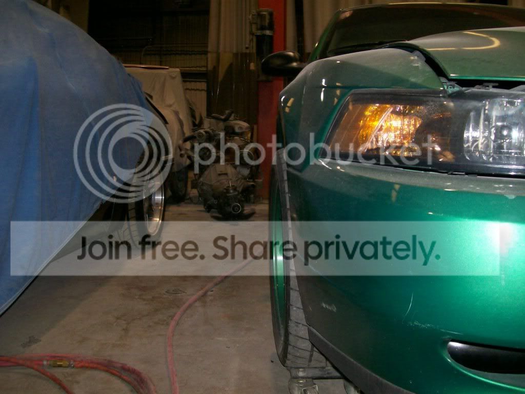

so i have a qa1 tubular k member on my 01gt and the driverside wheel sticks out past the fender about 3 inches. 17x9 deep dish bullitts on the fronts. a buddy of mine has a tt 96 cobra with a tubular k member and his driver side wheel sticks out about 1-2 inches. he has 17x9 oem machined 03 cobra wheels. anybody else have this problem, or has had this problem and knows how to fix it? i'm taking and posting pics tomorrow or the next day.

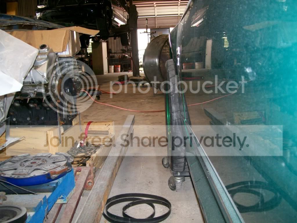

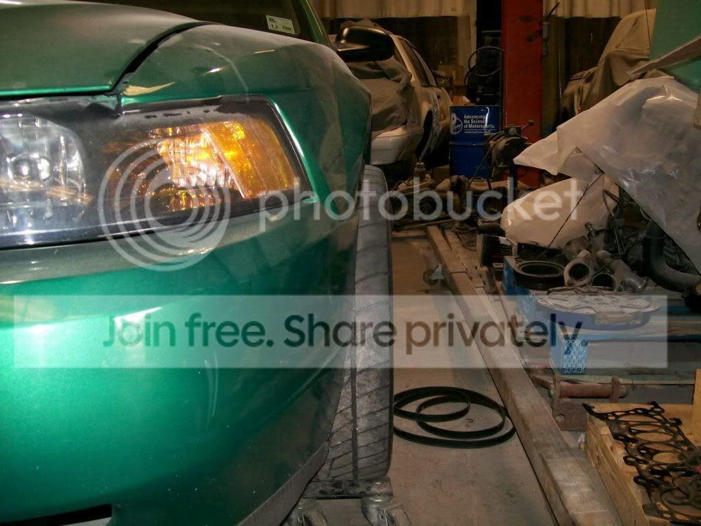

so had the same wheels on the car before the k member swap and they sat inside the fenders on both side, now the driver side sits out almost 3 inches.even if i could "square" the k member, then they would both stick evenly about 1 1/2 on both sides. wheel's not exactly straight in the pics, but it's just not right.
