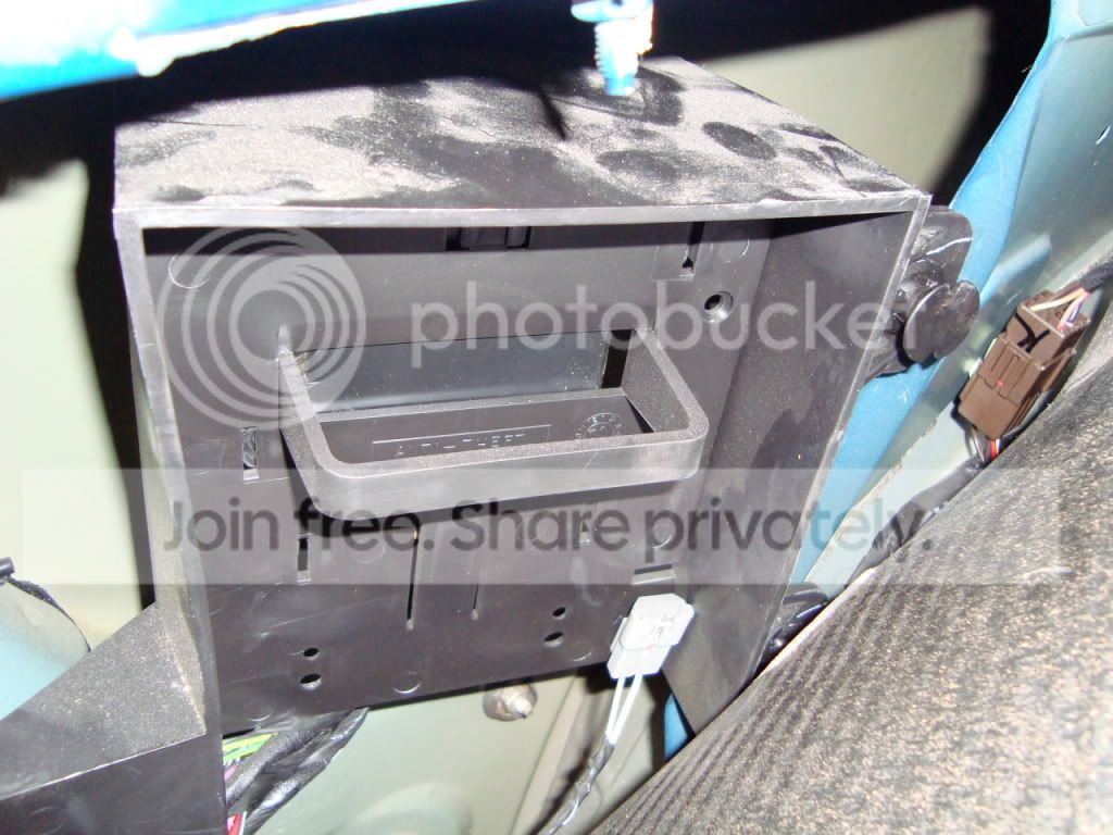

the "8 key turn" process only works on 99-present.
94-98 need to access the jumper connector in the trunk
edit: also, when i was junkyard hopping, i found a 98 V6 convertible and the keyless entry module was in the trunk like the coupes
you dont even have this black mounting bracket? the keyless module is actually behind this, there will only be a box on the front if you also have a factory Anti-theft in addition to the factory keyless. keyless and anti-theft are not the same
this was off my old 98 v6, it had Keyless entry with no anti-theft, hence no box in front but the keyless module was behind this bracket
