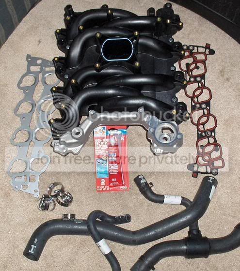

i decided to start collecting pieces to do the pi intake swap. i bought adapter plates from hps. i also am planning on putting all new hoses on the car at the same time. i was wondering if you need to buy the pi coolant tube or if you can just use heater hose instead? and does anyone by chance have the ford pn for the pi coolant tube?

You can use heater hose, just make sure it's really heater hose, the good high temp stuff.

J.R. - i've been wanting to go to summit but its a way longer drive. takes about an hour to get to jegs. i heard that summits showroom is huge. i really wanna check it out. so i guess ima get about 3 ft of automotive heater hose. i think im gonna grab a 180 t-stat too. i can't wait :dancing6:

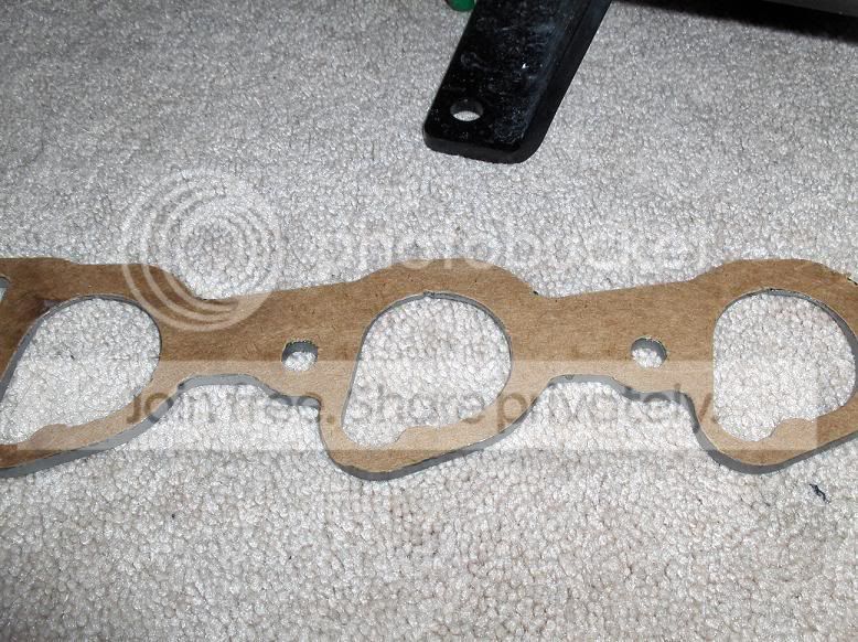

well i got them from http://www.hiperformancesolutions.com/order_page.html . i have to say that i wasn't as impressed with it when i got it. i wish i had asked alot of questions before i ordered. it was made out of steel and was painted silver which made it appear more like aluminum in pictures i saw. i would rather have it made from aluminum for many reasons. also they say only the pi gaskets are needed but im also gonna use npi gaskets on the other side. they got around using 2 gaskets by applying some type of cardboard material to seal the npi side. imo cardboard like material won't seal air or coolant very well. it also has you use silicone which is the opposite of what i wanted to do. i admit that i didnt research them well, and im not saying don't go buy from them. its just not what i expected for my 100bucks. im not trying to bad mouth them its just know what your getting into before you just buy things. i learned my lesson. here are some pics.

I've only heard good about them but damn that looks like shit.... But i guess when the other "good" plates are like 300 and those were 100 i guess thats why. But on the other question i would just go ahead and by the ford coolant tube and do the pi coolant nipple swap and also while your at it .. .get a new pump if a lot of miles or even an electric is NICE
