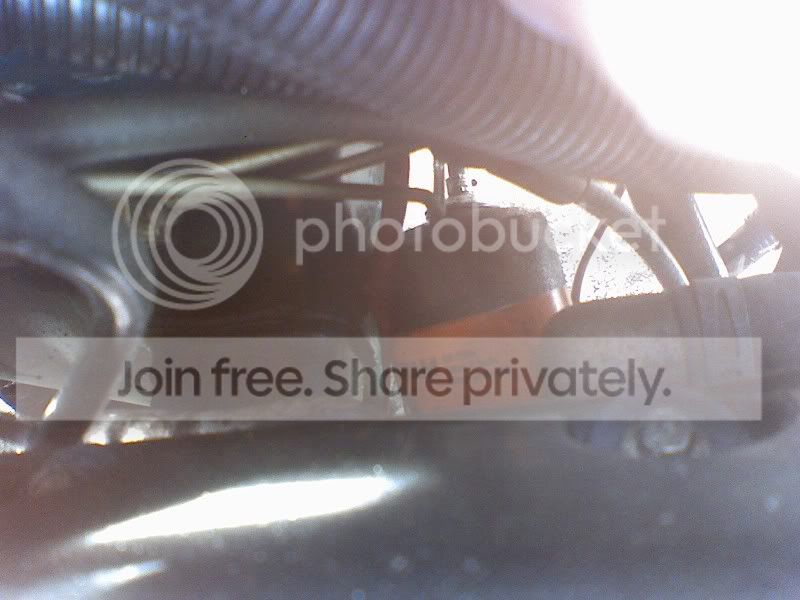

the other night i was driving and started to smell burnt oil.. so sure enough i was leaking so i got it home, luckally i wasn't too far away from my place.
the next morning i took some pictures
the camera angle was hard but if you look at the last picture you can see that the oil filter is against the K and it had actually shaved the top corner off of the filter. and had progessiveally started leaking

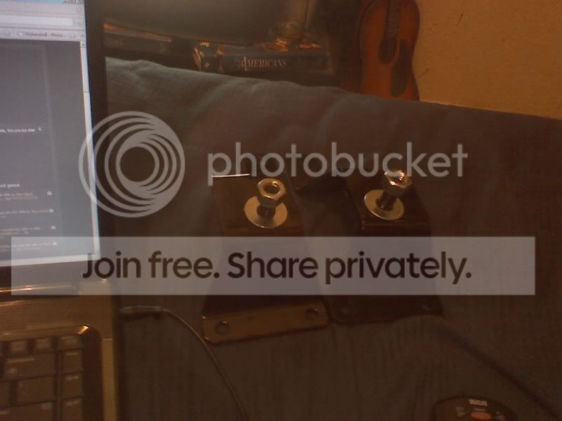

so my solution assuming that my motor mounts are snapped
was these solid motor mounts from Arts..

Willis_98GT:
Bummer! But it's a good thing that you caught it close to home before something worse than the smell of burning oil happened.
Hey, just some advice about oil filters... Check out "BobistheOilGuy.com" and read his oil filter evaluation. If you like your engine, it is worth reading the article!

Solid Motor Mounts = NO NO NO on your car. They are only for High horsepower cars and will piss you off driving everyday.
Order some Poly Motor Mounts.... they should do the trick.
I had this same problem a few months ago. My Motor mounts were shot and i was busting oil filters.
http://www.sn95forums.com/forum/index.php?topic=20315.0
Good news is your can still drive you car..... Motorcraft makes a filter with the part number FL-757. this is a oil Filter for a early 80's Honda Accord/Prelude 1.6 liter. The Filter is 1 inch shorter than the FL-820s and has the same diameter and threading. The Purolator part number is "L10291"
This filter gave me enough clearance to drive my car for a few weeks before i got time to change my motor mounts because i had to get to school. You can see in the picks where my oil filter was hitting the k-member.... but its clears the K-member with the Honda Filter. The fix literally saved my ass :coolsmiley:

Willis_98GT said:
why are solid motor mounts going to piss me off?
Because Handz said so, pay attention. :hammer:
You'll feel more vibration, I say, as long as you keep the trans mount urethane or rubber, go for it. It may also back some bolts out and crap, but big whoopdy do.

well i'm going to return the motor mounts and find a nice set of polys or something, i did go with greg's idea of putting a different oil filter on there, i couldn't find the one that he used exacally.. but i did get the filter off a 1983 1.8L accord.. its a fram PH3531. but it fits on and seals perfectally. not leaking a drop of oil yet clearing the K completely. its about a inch and a half shorter, and will only be on there temporally until i can get new motor mounts on.. man ordering the cobra t-45 on friday too. geeze this is going to be a eventful month..
