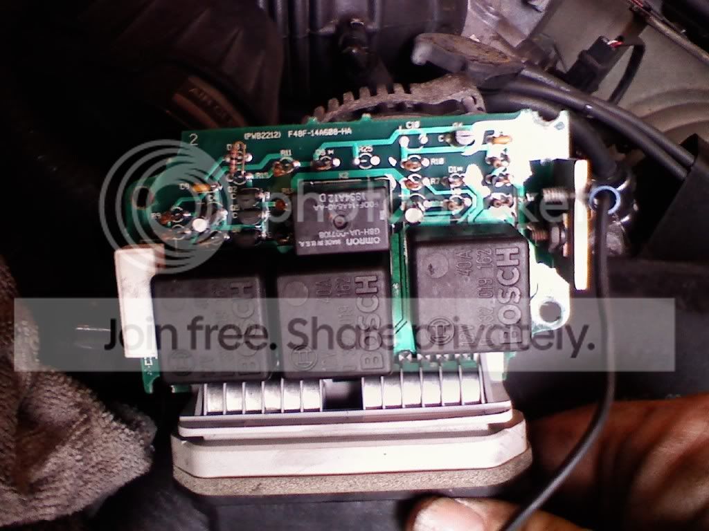

oh and by the way.. i forgot to say that it did fix my problem with my a/c clutch kicking on. It works like a champeen now. i still left my manual switch hooked up just in case though.

yeah.. good luck.. hope it comes out well. mine had the a/c clutch, fan, and fuel pump relays go out so i replaced it.

So replacing the CCRM fixed yours?
I'm having the same problem and am looking for things to test and stumbled upon this thread..

well idk yet, i tore my ccrm apart and it didnt look anything like what the diagrams he gave me. But if anyone can tell me which relay i need to replace, please let me know.

That is the big box that mounts to the back passenger side of the radiator right? I think i'm going to start with the switch on the accumulator and go from there.
Have you looked in any junkyards for other CCRMS(What does that stand for anyway...) And tried them?

yeah, its on the passenger side mouted with the overflow tank on the radiator. I dont really have any junkyards to go to. But you can get a new one (well probably refurbished) from advance auto parts for $83.99. I just looked today when i went. But it stands for constant control relay module.
