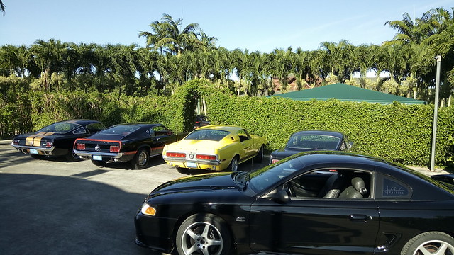

The Steeda was invited yesterday to a Ford Mustang shooting because they were missing an SN95 and they wanted all generations present. Although they wanted the Cobra, I took the Roush instead :) Bold but it is what it is. At the end, it was one of the best car days of my life.
A quick shot I was able to squeeze in:
We also did a drivealong at the end of the day with these and a new red GT350:
That nose you see on the left is a 68 GT500KR vert:

That is very cool.
That's awesome! Looks like it should have been a little Hotwheels!
Yea. There is hardly any SN love with HotWheels so this one is definitely one of their best lol
a steeda and a roush, man jealousy is an ugly thing but I can't help it... :icon_salut:
lol Don't be. I'm at a point in my life where I can get away with it. Always at your service in South Florida.
