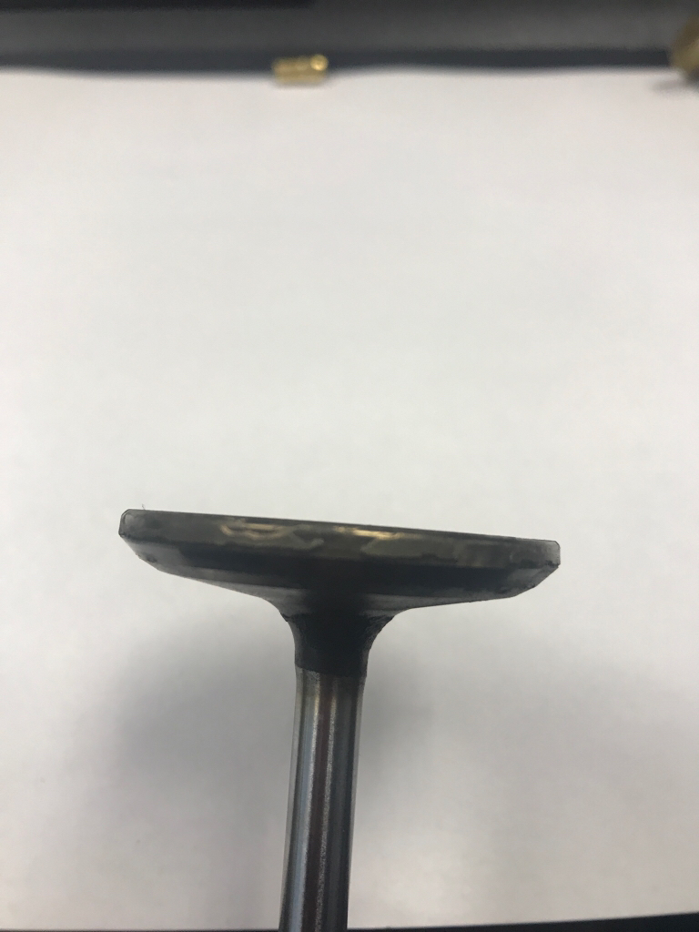

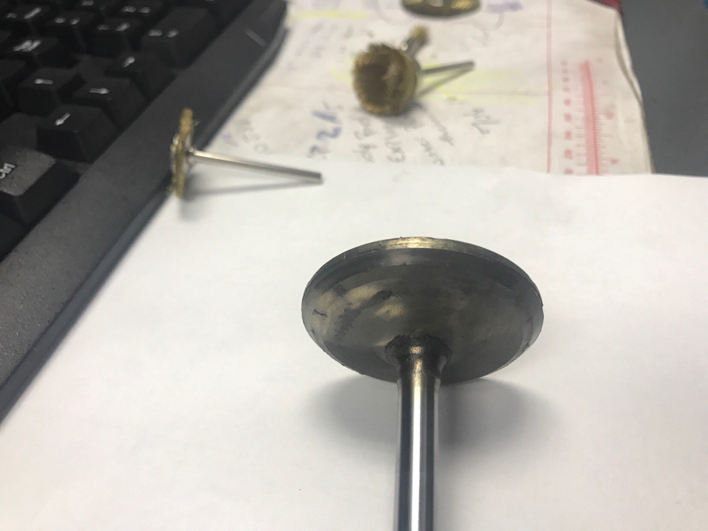

So the heads are now bare finally good news is they cleaned up pretty nice and are ready for machining
Bad news (or at least I think could be bad) are some of these valves look a little rough [emoji19]
I’m going to finish cleaning them all up and see how many of them end up looking like this.

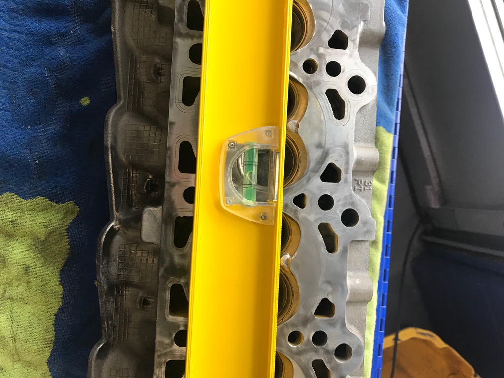

Well a few brass wire wheels later the Windsor heads are ready to be sent off to the machine shop
Hopefully all will come back with good news sending them in to be checked over and get a estimate on have them decked.

Well that didn't take long.....got the call in this morning from the machine shop and the heads check out good.....even got an "at-a-boy for me cleaning I did which saved me a few pennies....(now only if they would offer me a job at a performance shop:grin:)
so as it follows it is gonna cost $150 for them to make a skim pass across them or the will deck it what ever spec I would like so I am thinking of going with "OLD H2S" original suggestion and get the heads decked (60,000ths)
Then they are saying that need my valves to ensure everything lines up properly, and from there it would be another $200 to reassemble everything....have not done any searching around on pricing yet but that seems to be reasonable
and once I bring it all in im looking at two day turn around.
