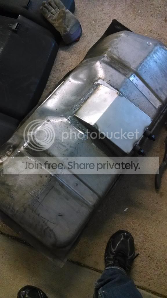

Got a little bit done this weekend. I am hoping to finish it up and get the lines ran this week. May 17th is coming up quickly haha.
I just need to double check the seal, and then clean it up and paint it. Fit the cover and mount it back up. Need to get a spot to mount the pump. Any ideas??

Looks great man, can't beat the look of a sump on an sn95. To give you an idea, here is where I mounted my pumps before putting the tank back up under the car:

Right on, that look really nice. My pump is a low pressure pump tho and it is actually pretty big haha. like the size of a power steering fluid tank. I think that will be my mission tomorrow. They do look so sick on these cars. Yours looks really clean
