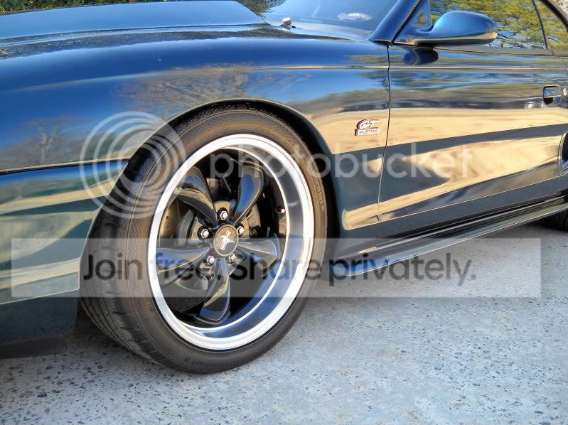

would you please enlighten me on these wheel well liners? We talking front or rear? Front I'm assuming.
They are for the front. The factory Ford drivers side liner has a little "box" built into it that will sometimes rub the top of the tire. The aftermarket liner is smooth throughout the entire liner and gives a little more clearance.

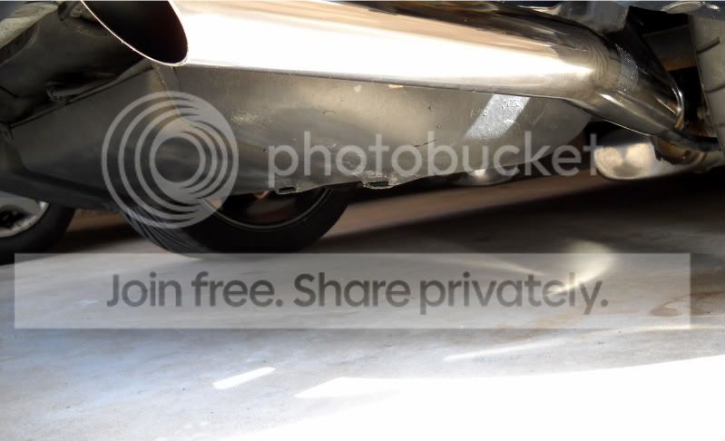

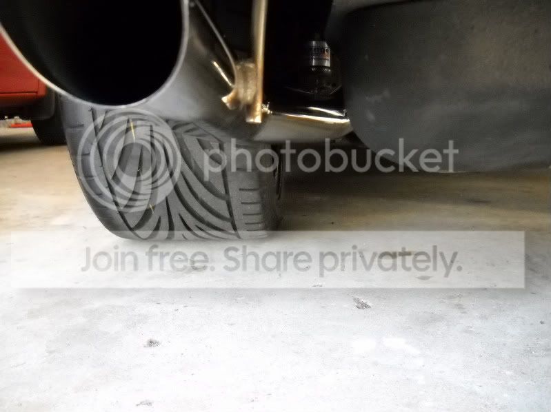

As I said earlier, I spent most of yesterday detailing my ride.
Decided to clean and polish my Pypes SS Violator system. Hand polished the tailpipes and the mufflers:
A little off topic, but added Motorsport 3.73's, fully rebuilt the carrier with carbon discs, and modified a differential cover from an '04 AWD IRS explorer. I need to sand and coat my undercarriage. My fuel filter cover has seen better days. Will refinish and coat that as well. All that is coming asap:
Added U/D pulleys. UD waterpump and crank, OD alternator pulley, and some misc engine bay shots:

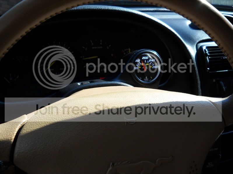

Added a steering column pod and water temp gauge:

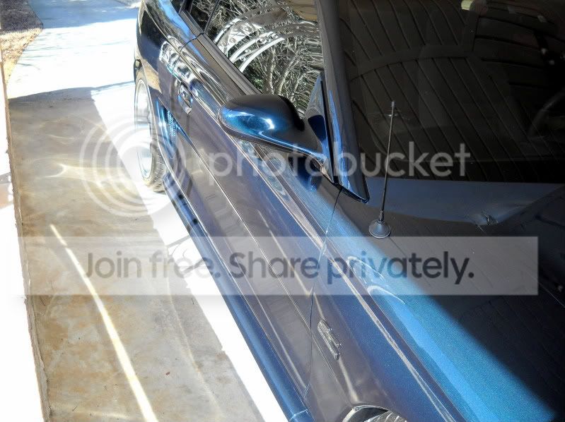

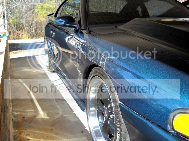

The car after polish and wax:
Looks sooo clean man, I can't wait to bust out my stang. I havent even SEEN mine in months :sad5:

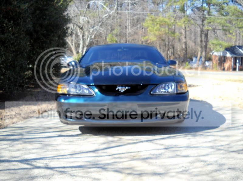

does that huge gap under your corner lights bother you at all?
Thanks! And yes it does. I ordered a new header panel last week.
