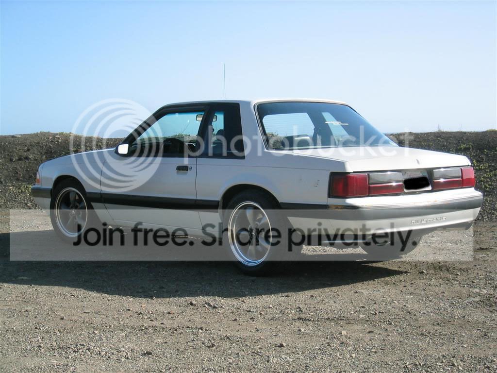

The car:
Basically, about 5 years ago I bought it for $500, 4 banger, automatic, gray interior, rod knock, clean title, pretty clean body/paint, I'm in CA so there's no rust.
I used a donor car, and swapped in a stock 5.0, T5, and changed the interior to black.
I ran a best of 13.01 @ 104mph with a 1.7 60' with the stock motor, 3.73 gears, slicks, short belt, longtube o/r exhaust...basic bolt-ons

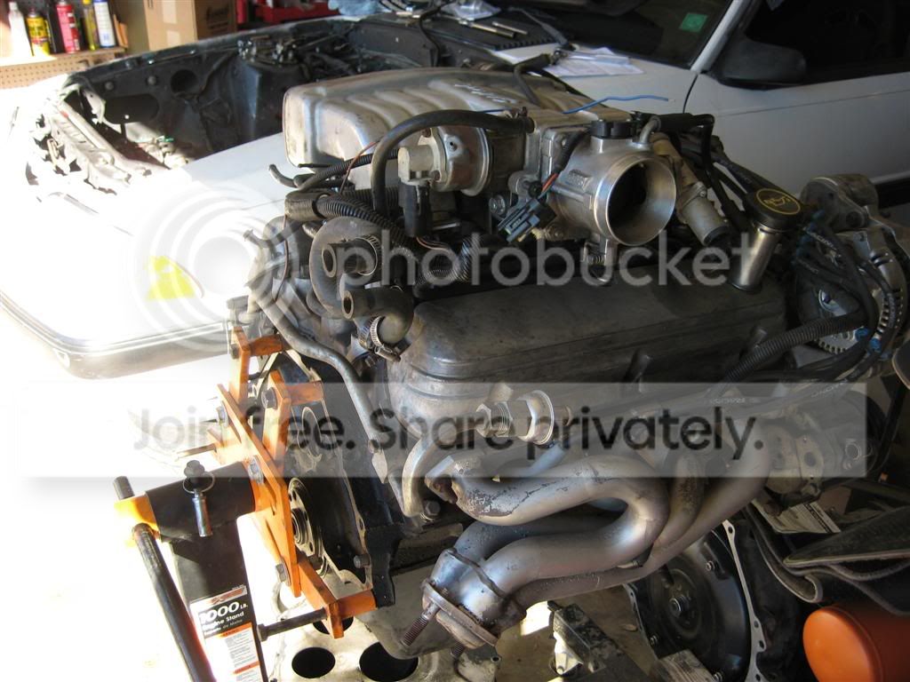

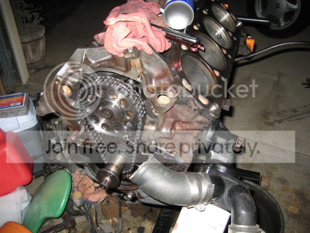

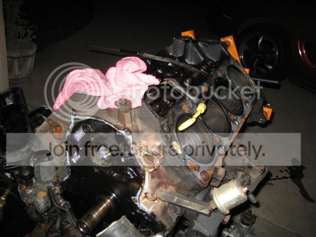

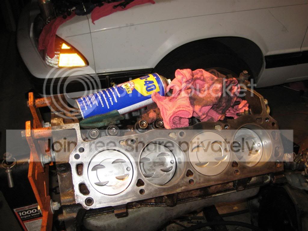

as it turns out, it had a blown head gasket, interesting.
stock shortblock cleaned up, just some simple green, wd40, and scotch pads

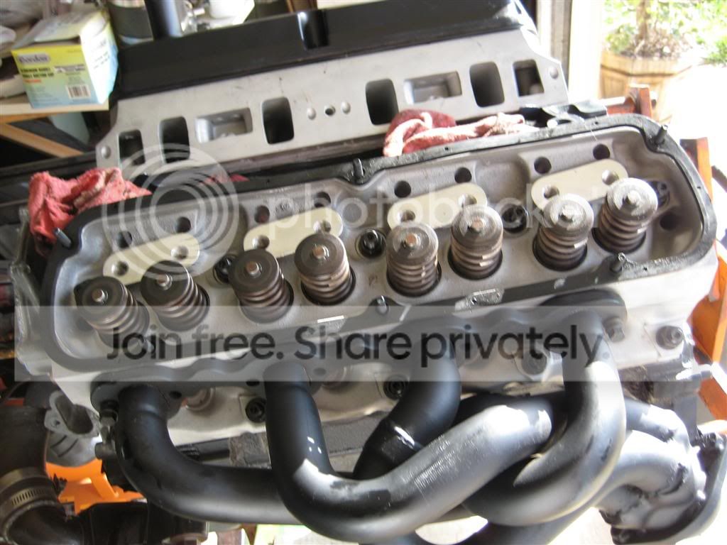

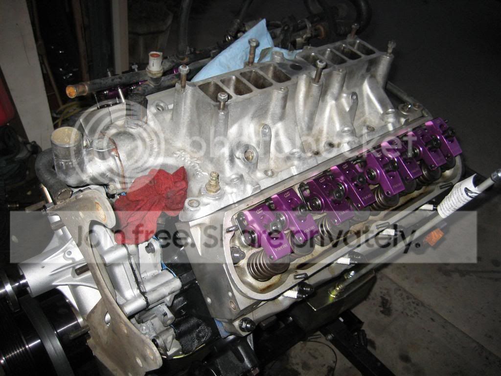

new cam, and billet timing chain set
new heads, head studs, and headers
carb legal, one of my requirements, has to be a street car :)

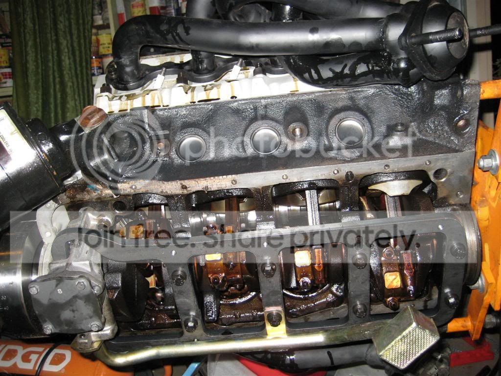

the guts of the canton road race 7qt oil pan with baffles
main girdle + arp bolts
1.6 rr's

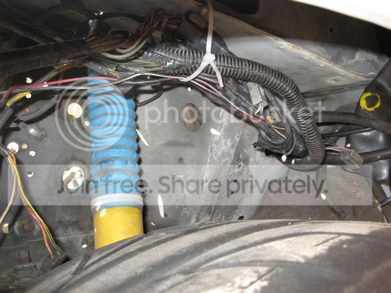

hiding the engine bay wires in the fenders
looks better without the rainbow barf all over it :)

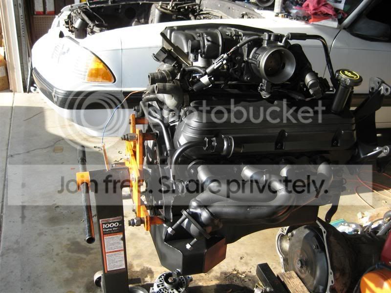

repainted the engine bay, last time I just used primer, this time went 2 stage with an acrylic on the top
trying to hide this the best I can

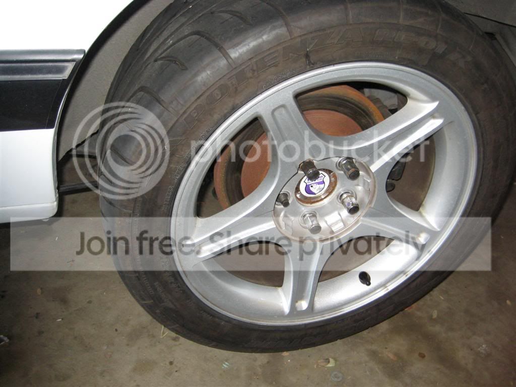

the new street wheel/tire setup, probably going with enkei RPF1's with r-comps for the track next year

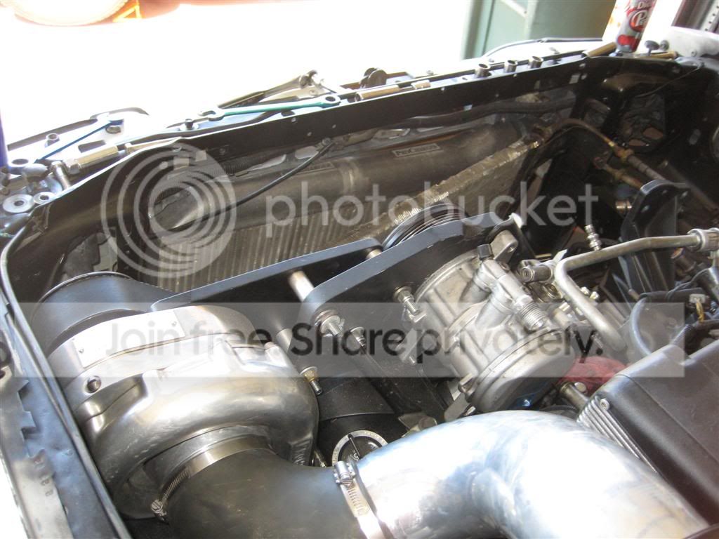

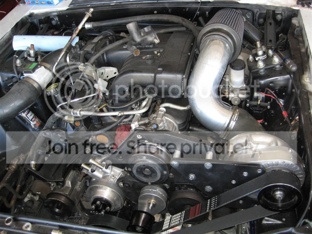

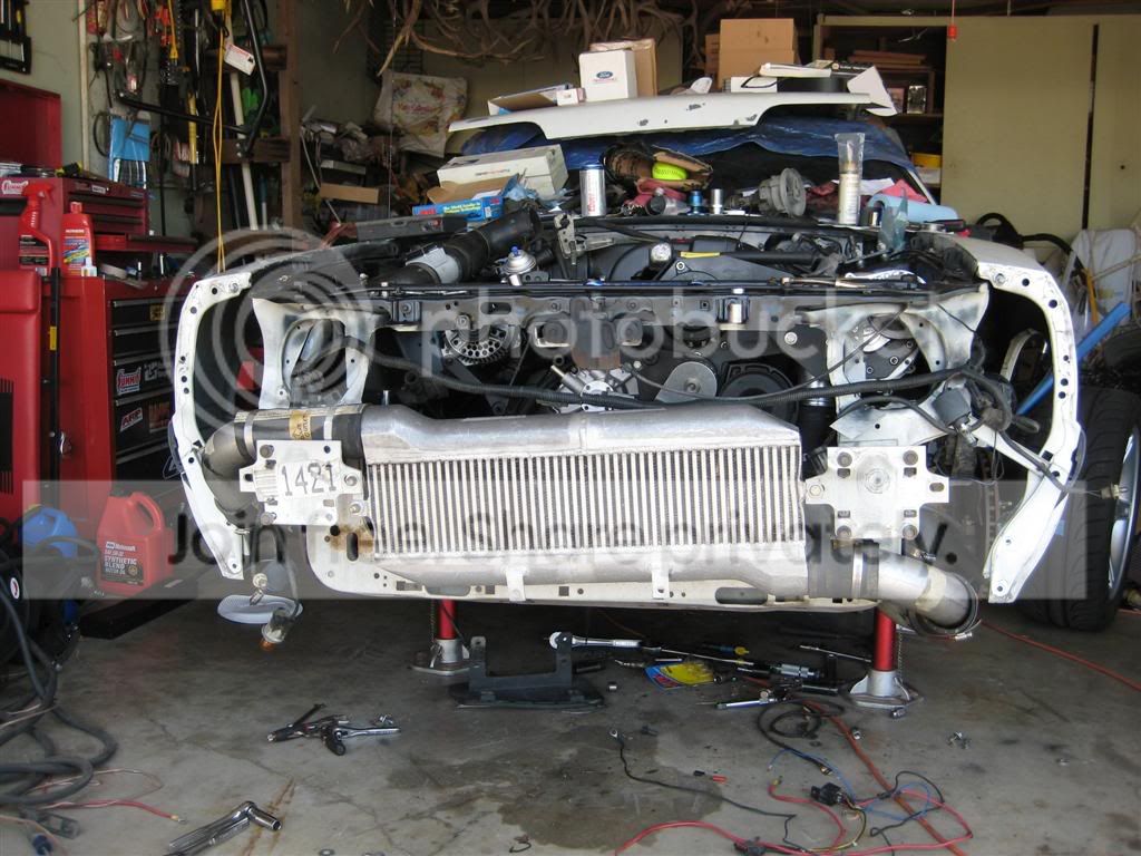

can't hardly see the intercooler (which is a 3-core procharger air-to-air setup)
filter will be in the fender soon, just have to measure a few more times before I cut the 5" hole for the power pipe
can't use my mark8 fan anymore with the 12-rib procharger belt setup, a stock clutch fan barely fits, I had to trim the stock shroud, probably because of my radiator being larger.

Glad you said you were mounting the filter in the fenderwell, had me going whaaaaaaaaaat? Looks good, from one procharger owner to another, you will really enjoy the boost. One thing tho, if you can't see the intercooler, it isn't getting airflow and isn't doing a darn thing. Just thought I would throw that in there. Plus, it's not like people can't here the blower when the car's running, lol, so it's not a sleeper.
