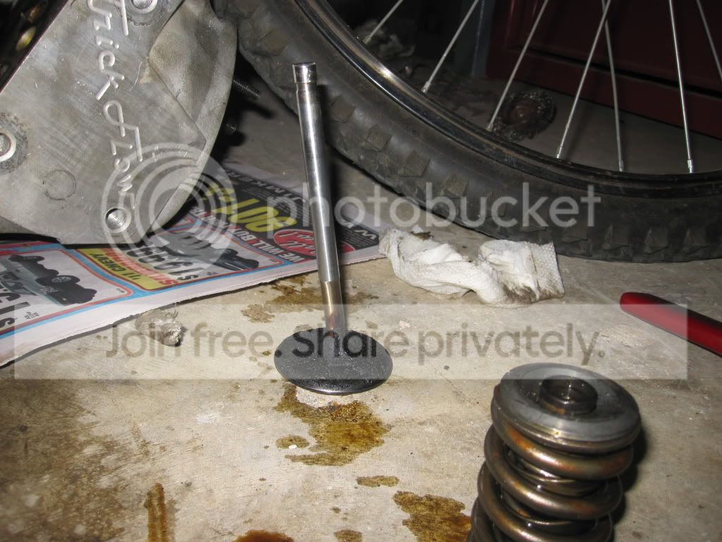

My father is gonna help so that eases things some. I figure I'll lay on my back and guide it in.(giggity) HAHA Sorry. Got it torn down to just heads, block, and headers. All wiring is moved, power steering pump is dropped out of way and ac is also moved to other side of bay,without kinked lines(proud of myself). I figure since we're going to be getting a good bit of snow soon, I will spend some time cleaning up the wiring so and whatnot. So far it looks like I only bent one valve judging by spring height with the rockers off. If its not nasty tomorrow Ill go ahead and try and grab a motor I suppose Ill have some more pics up soon. As soon as it comes out Im tearing it down so we can see the destruction.

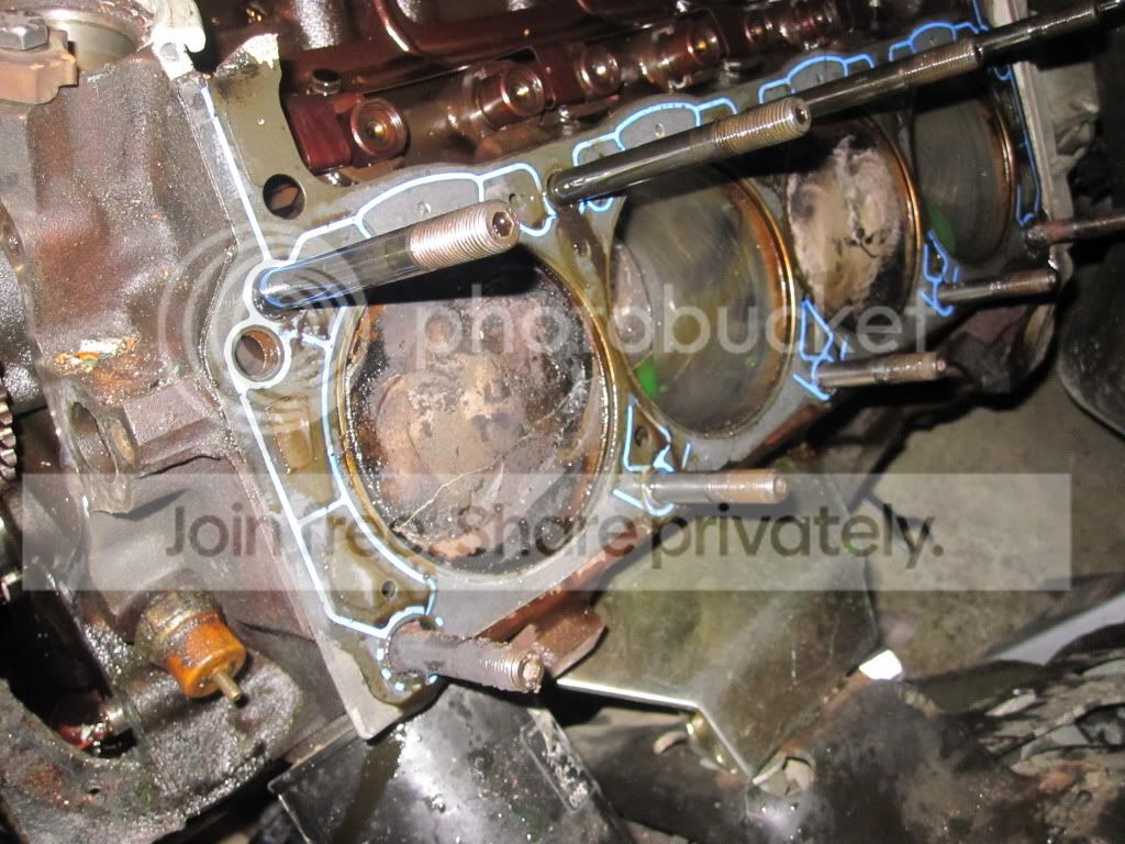

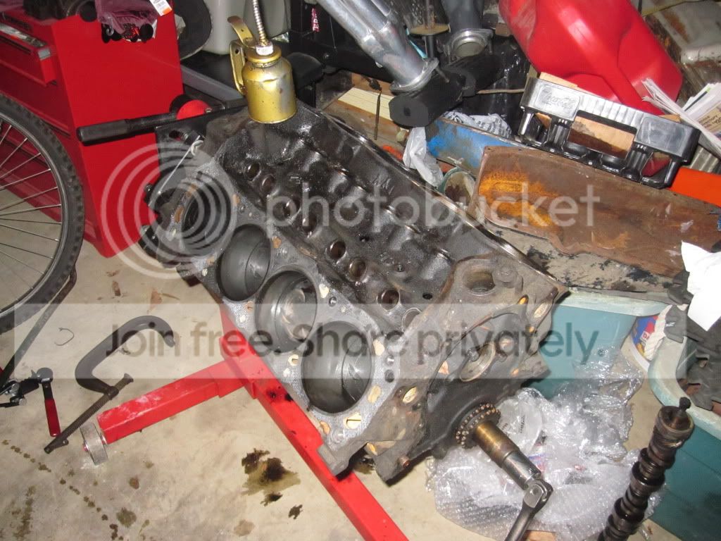

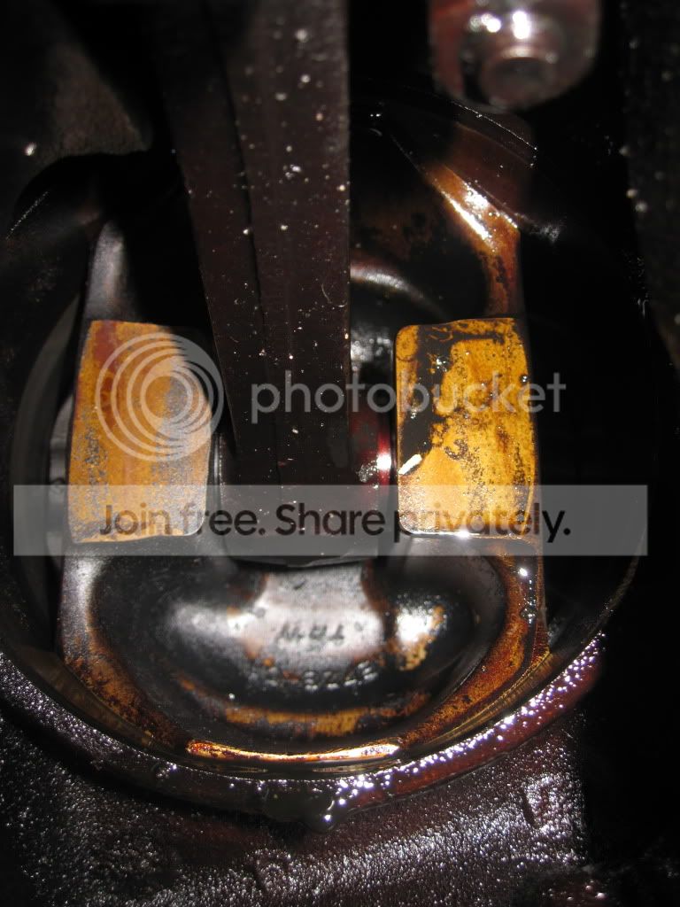

Ok, got a little more work done today. Its been snowing here which is something we arent used too. Got the heads off to start looking at valves. Only one valve was bent, thank goodness. However it seems that one spot on the other head is kinda off. I had an issue when I installed the heads. The guy who sold me the cam said i would be fine installing it 4 degrees advanced. Well this lead to me bending a few valves due to pvc issues. Not much of an issue you'll see by the pics. Pics of new shortblock are also included. Its a '91 shortblock, all bearings look good, piston bores are in good shape, and they do have the forged pistons.
Yepp thats a cracked piston.
Not an optical illusion. Ha
Here you can see the small spot that was previously messed up(The right one). Seems to cover the sparkplug up some. I suppose its ok?
'91 Shortblock
TRW forged slugs. Pretty happy about that

dad went out and found another broken piston that i missed. so 5 and 8 are cracked. something else that was wierd is the number 5 pistons is actually twisted. not sure if you can tell in pics but its not lined up the same as the rest.
