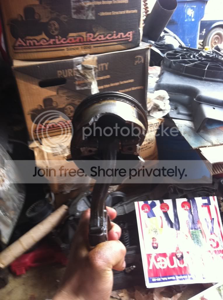

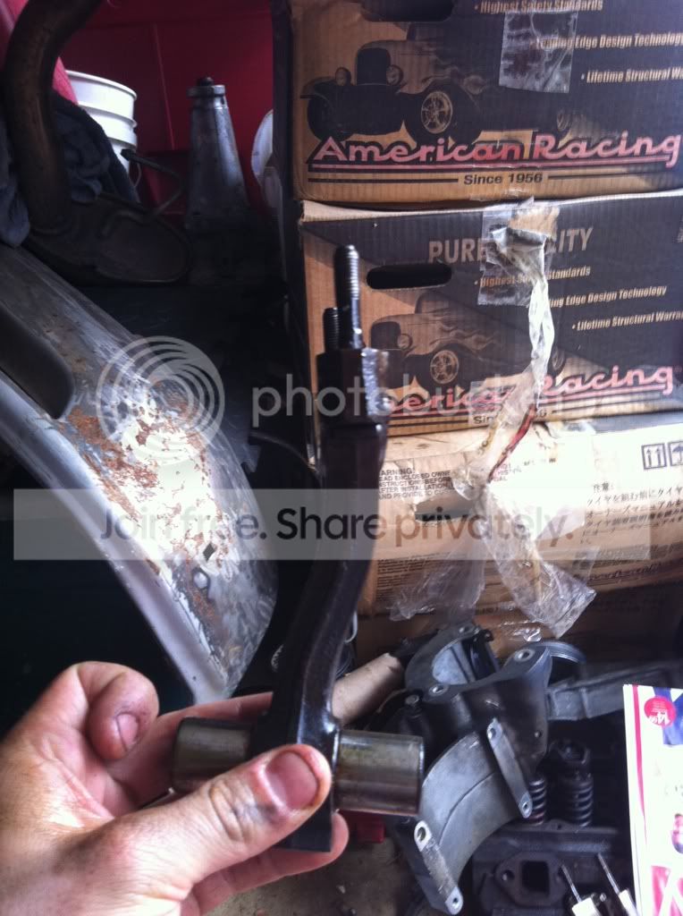

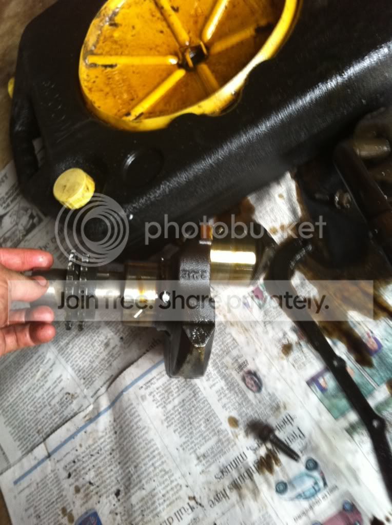

Sorry guys. Ive been outta pocket. First lost my iPhone then computer went now I have both back. Here is the update. Block had to be bored 40 over so I went ahead an ordered a set of forged pistons. The crank was ground 10 over. All I'm waking on now is the bearing to show up so I can take them to the shop to have the assembly balanced. I've been going awfully slow since parts are slow arriving. I was able to remove the old block and see the damage. The first rod journal cracke at the counter-balance. Both front rods bent and both pistons cracked. Once that was all removed the rest of the crank spins by hand. The cylinder walla still had cross hatchings in them :( had it not been for the enormous hole in the block it could have been salvaged. If I can figure out how to post pica up from iPhone I will so so.

Lol the only thing holding the pistons together are the rings ha. If it would've been a clean break I'd prolly still e able to use the block. It's ridiculous how clean the motor was. Makes me sad guys. No carbon ring, cross hatching still there. No sludge anywhere. Oh well. This one will be taken care of well. As soon as funds fall in order I'll pick up a higher quality balancer. I've been told romac is good. As well I'm entertaining the thought that she will run tons better. I also figured out a way to reloom the wiring harness so I do not need o2 extensions.
