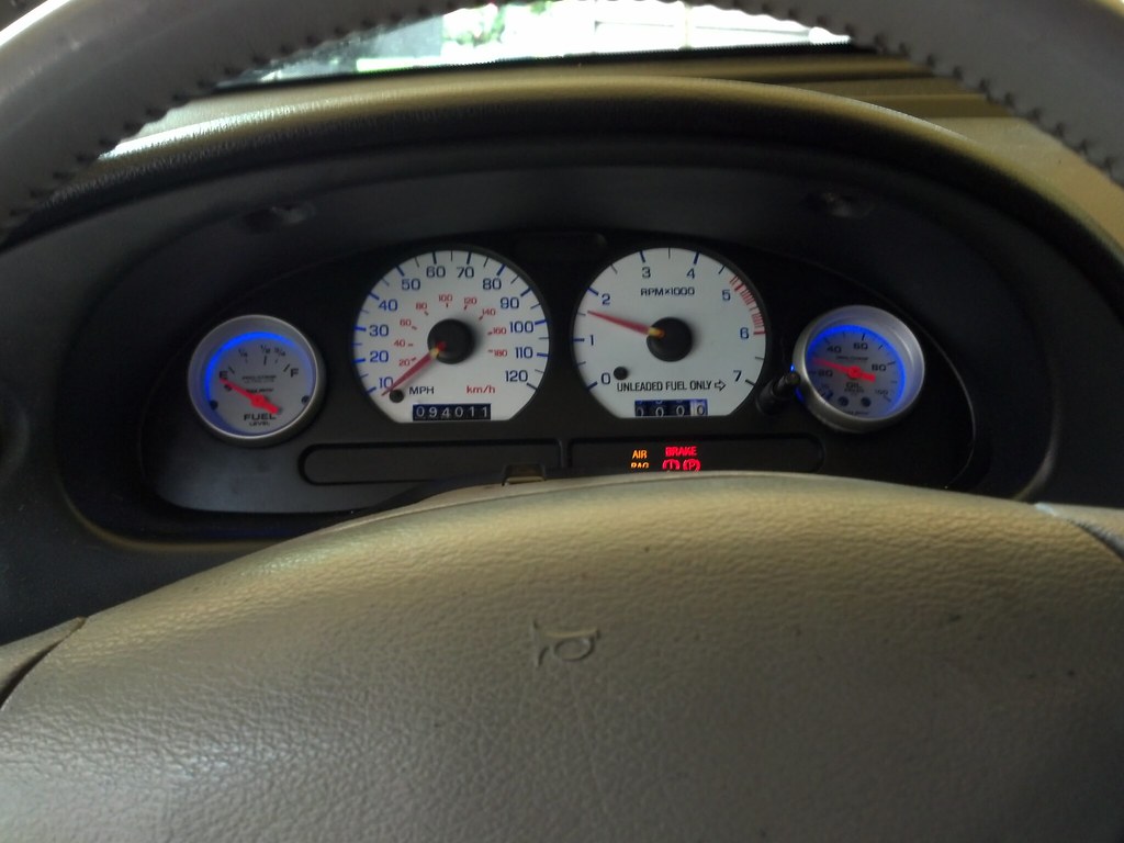

This one started off as a roush cluster, owner wanted an oil pressure gauge added in to get rid o the dummy gauge.
Cluster and OPG as received:
Bezel and lens removed as a unit:
Lens removed from bezel:
Gauge over lay, oem oil pressure gauge removed, area to be removed front and back:
Overlay trimmed:
Bezel hole outlined:
Bezel hole cut. Relief cuts made to allow the gauge to sit flat without severly hacking up up Autometer bezel or the Gauge bezel:
Test Fitting:
Primer:
Will update with final pictures once i buff out the lens!

I had that cluster, fitment sucked. Pissed me off everytime I looked at it. So I personally did this:
This one was for a buddy for his racecar. And I got the fuel pump I needed out of it.

Thanks guys! I did mine for fun and his on a trade! If anyone is interested I can do yours too =D pm me if you're interested!

You did a great job on my cluster bryan I appreciate it.
And for the people running the dual dash pods, if having two oil pressure gauges, one useless and one functional is your thing, then that's cool. I had an autometer 5 gauge panel for my car, I got rid of it because I'd rather still have the functionality of the rest of the gauges. mainly the oem tach and speedo.
